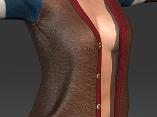

Find the Material drop-down list and set the value from the original one (Cotton) to Leather.
The texture of the fabric will be changed accordingly.

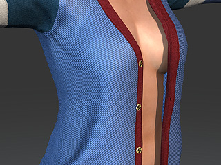

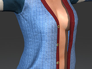

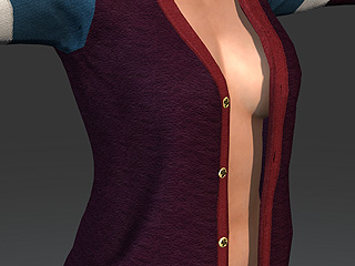

The original looks of the embedded fabric templates are as shown below:
Cotton

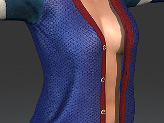

Denim
Leather

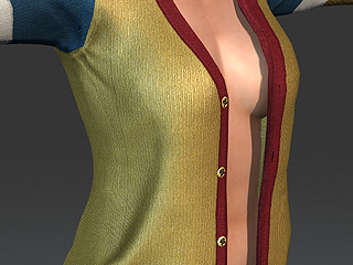

Wool

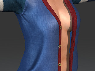

Spandex
Nylon
