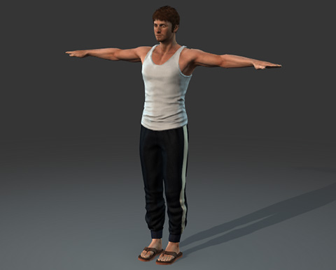

Prepare a character (nude or clothed).

You can then play back and check out the Skin Weight of the
clothes, already-dressed or customized ones in a 3rd party 3D software.
The calibration motion for checking skin weight of the clothes.
Using custom motion is possible for certain scenarios.
