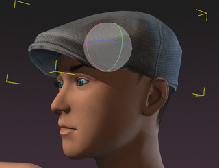

Rotate
Drag the three circles around the object to rotate it along the 3 axes.

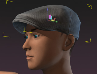

Transform
Drag the handles to move the object along the 3 axes.
You can also drag the square at the corner to move the object on the planes of two perpendicular axes.

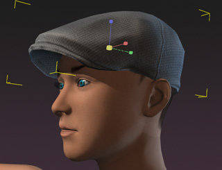

Scale
Drag the handles to scale the object along the 3 axes.
You can also drag the yellow cube in the center of the gizmo to scale the object at a uniform ratio.
