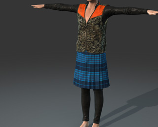

The default and recommended cloth collision layer ordering is as shown below, any clothing with greater numbers can cover the clothing with lower numbers:
You can customize the layer number to adjust the order of coverage.

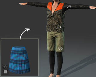

  • Applying a cloth template will replace the one worn with the same layer ID.
    The template with 5 is applied.
    The character's clothes numbered 5 will be replaced.

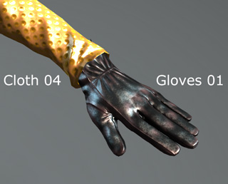

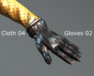

    • Gloves:
      The gloves are set to the Gloves 01 layer.
      The gloves are set to the Gloves 02 layer.

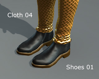

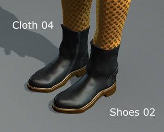

    • Shoes:
      The shoes are set to the Shoes 01 layer.
      The shoes are set to the Shoes 02 layer.
