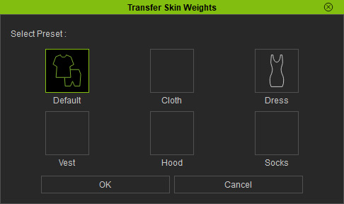

- However, if you choose the Fit Body Shape radio button, then you will be asked to choose a skin-weight transferring method for the clothes.
Before CC 5.2
After CC 5.2
- Pick the Default button, in this case, and the skin-weight will be re-assigned and the penetration will be
resolved.
