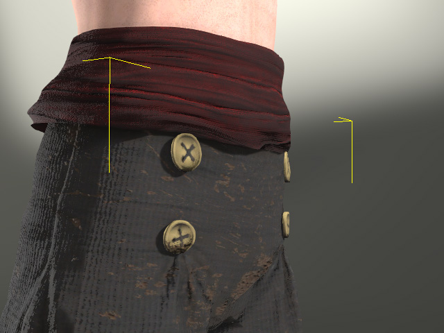

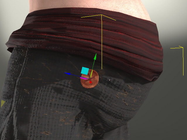

The original shape of the pants.

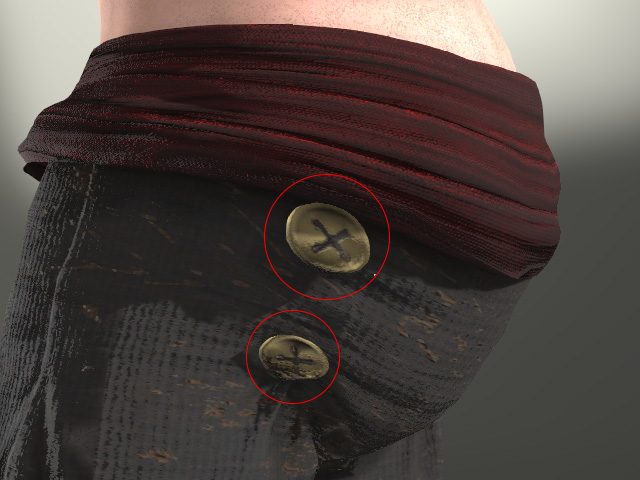

The buttons are distorted when you morph the body shape.

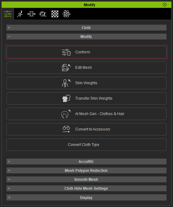

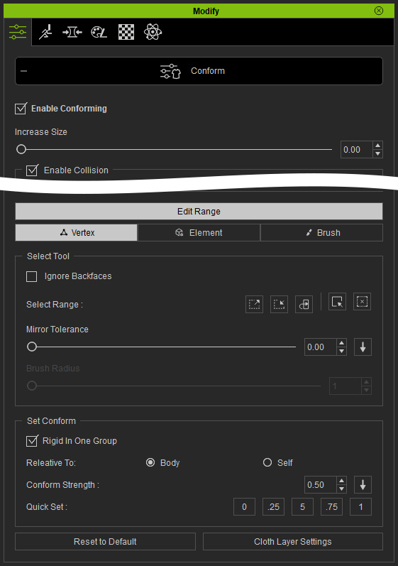

  1. Select the pants in question.
  2. Click the Conform button under Modify > Attribute > Modify.

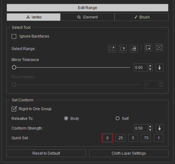

  3. Scroll to the Range group, click the Edit Range button.

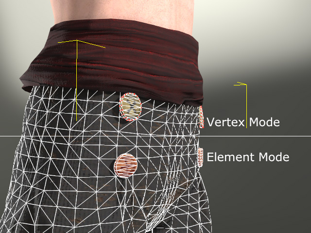

  4. Select the vertex or elements that are not to be conformed (in this case, the pant buttons). For more information about on the modes for selecting the vertices or elements, see Selecting Mesh Faces.
  5. Click the 0 button in the Quick Set group, then exit the Conform mode.

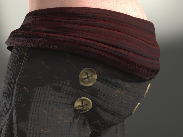

    The selected vertices or elements will not be conformed.
  6. Morph the body shape of the character and notice that the non-conformed elements do not deform with the rest of the model.

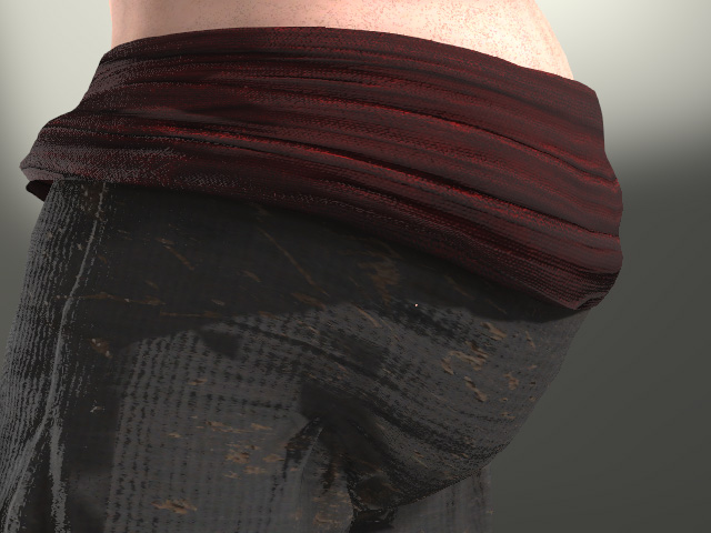

  7. You can utilize the mesh-editing to transform the elements with hard surfaces.
  8. Leave the Mesh Edit mode, now that the pants properly deform.
