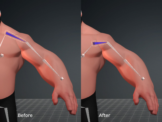

You can choose one of the modes to transform the selected bones. These radio buttons are only enabled after the skeletal structure is generated.
- Selected: Only transforms the selected bone.
- Hierarchy: Transforms the selected bone
along with its child bones.
