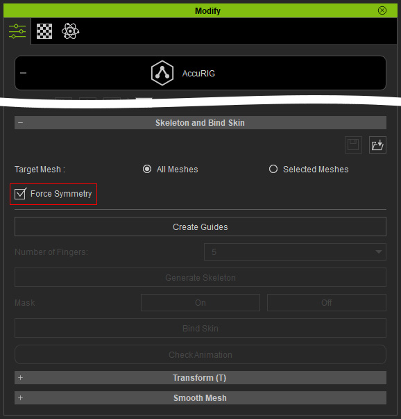

Using Force Symmetry for Fully Symmetrical Models
With Force Symmetry on, users can be confident that
the skeleton stays symmetrical during the creation and editing process,
thereby saving a significant amount of time and effort.
Force Symmetry creates symmetrical guides for the whole model, with the right side as the reference. It does not mirror individual adjustments from one side to the other. For that, you'll need to use the Symmetry Selection checkbox.

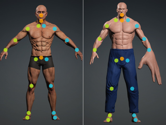

Force Symmetry for Generating Body Guides
Force Symmetry activation depends on the body shape
of the imported model.
* Hands are not considered for creating
symmetrical guides.

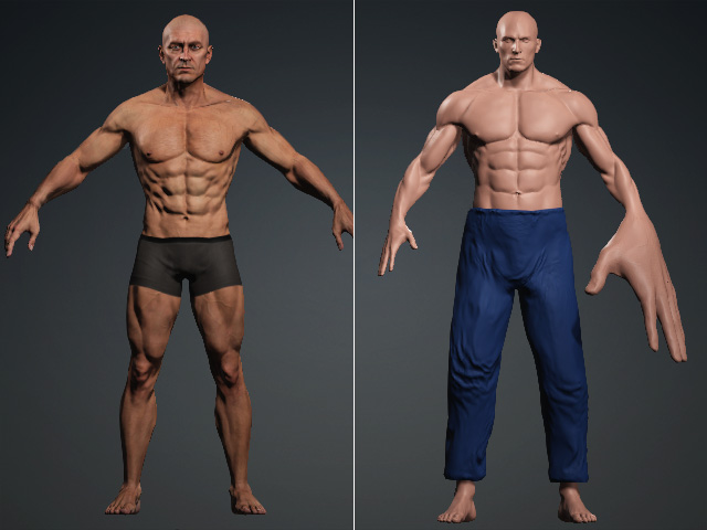

- For perfectly symmetrical bodies, you can activate the
Force Symmetry checkbox to generate mirrored guides.
Before
After

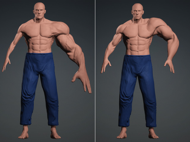

- For asymmetrical bodies, deactivate the Force Symmetry
checkbox.
Before
After

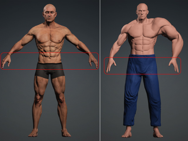

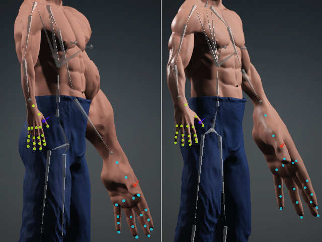

Force Symmetry for Generating Hand Guides
Force Symmetry activation depends on the hand shape
* The rest of the body is not considered
for creating symmetrical guides.
- For perfectly symmetrical hands, activate the Force Symmetry
checkbox to generate mirrored guides for the hands and
fingers.
Before
After
- For asymmetrical hands, deactivate the Force Symmetry
checkbox.
Before
After
