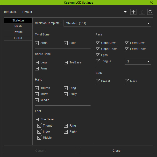

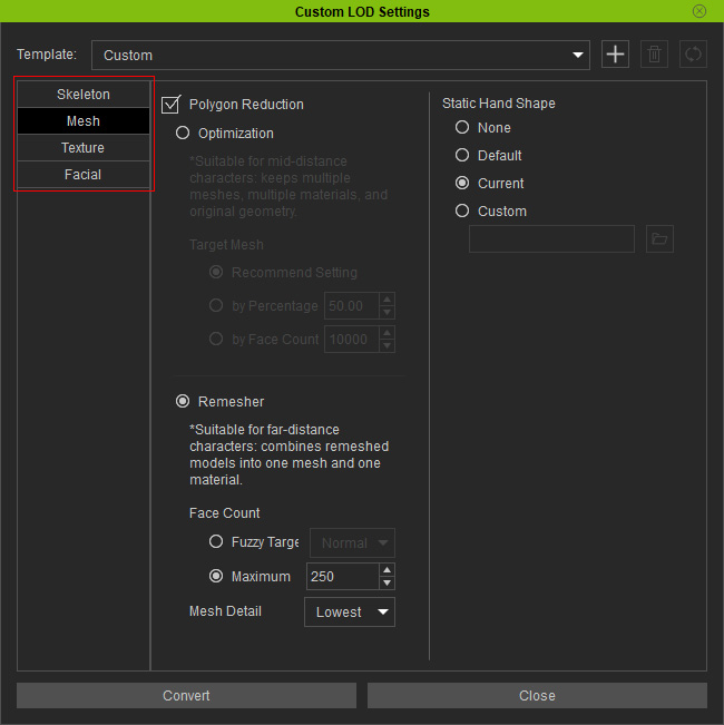

- Follow the steps in the Customizing Character Levels section until the Custom LOD Settings panel is launched.
- Adjust the settings in the Skeleton, Mesh, Texture and Facial tabs as
well.

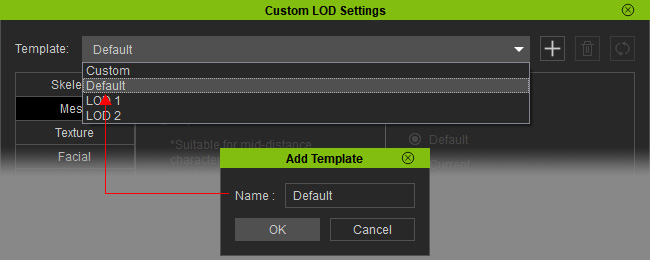

- Click the Add Template button.

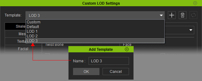

- Type in a name for the template in the Add Template panel.
- If you type in a custom name, then you will create a new template in the drop-down list.

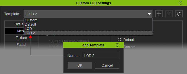

- If you type in Default, LOD 1 or LOD 2, then you will overwrite the original settings in these three template. In this case, the LOD 2 is taken as an example.
- If you want to overwrite the
"Default" settings, then type the name "Default" and the settings will be replaced.
- Click the OK button.

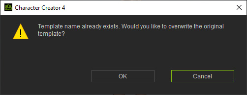

- You will be prompted to overwrite the original settings of the template. Click the OK button.
- The template (LOD 2) is now customized.
