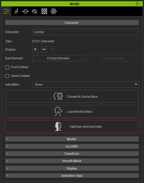

  1. Apply a CC1 or CC3+ character (converting the CC1 to CC3+ is recommended).
  2. Click the Optimize and Decimate button in the Modify panel.

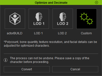

  3. Click the Custom and Convert button.
  4. You can customize the settings in the Custom LOD Settings panel.
  5. Deactivate the checkboxes or change settings in different tabs for optimization and decimation.
  6. Click the Convert button. The character will be optimized according to the settings in the Custom LOD Settings panel.

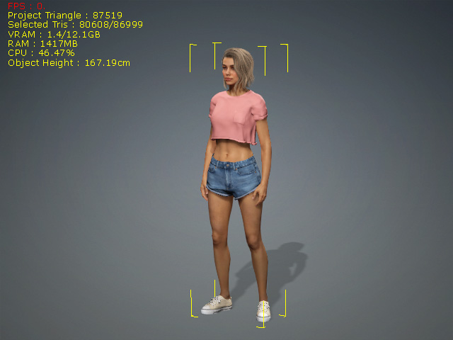

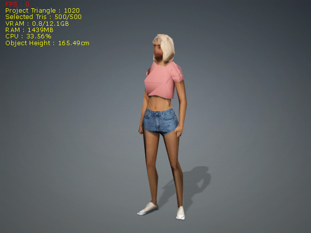

    In this case:
    • Skeleton: LOD 2 -- 22 bones left.
    • Mesh:
      • Polygon Reduction -- Remesher with max 500 faces and the most mesh details.
      • Static Hand Shape -- Current
    • Texture:
      • Texture size -- 512
      • Material Channels activation: Diffuse, Opacity, Metallic, Roughness, and AO only.
    • Facial: Only Head Rotation is activated.
