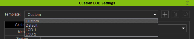

- Template: You can quickly adjust the settings by making a
selection from this drop-down list. The original items in the list are Custom, Default, LOD 1 and LOD 2. If you adjust any setting,
then the template will automatically change to Custom.
You are allowed to change the settings of Default, LOD 1 and LOD 2 templates. - Add / Overwrite Template: Click this button to add a new template or overwrite the settings in the existing template.

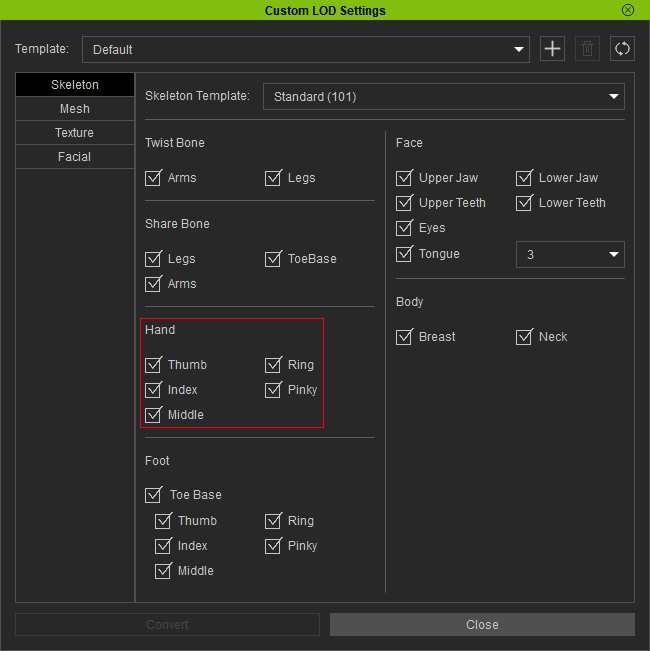

SkeletonDeactivate the checkboxes to remove the unwanted bones.

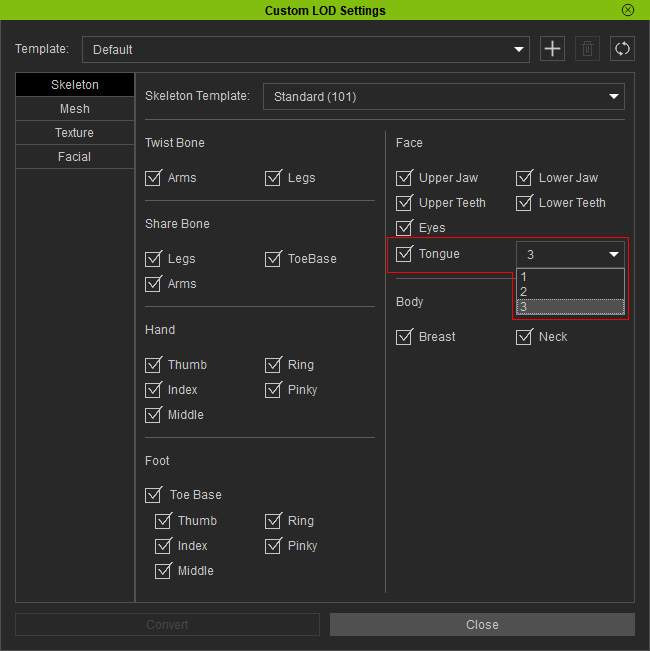

Tongue BoneThe tongue bones are originally composed of three bones. You can use the drop-down list to set the number of the tongue bones after conversion.

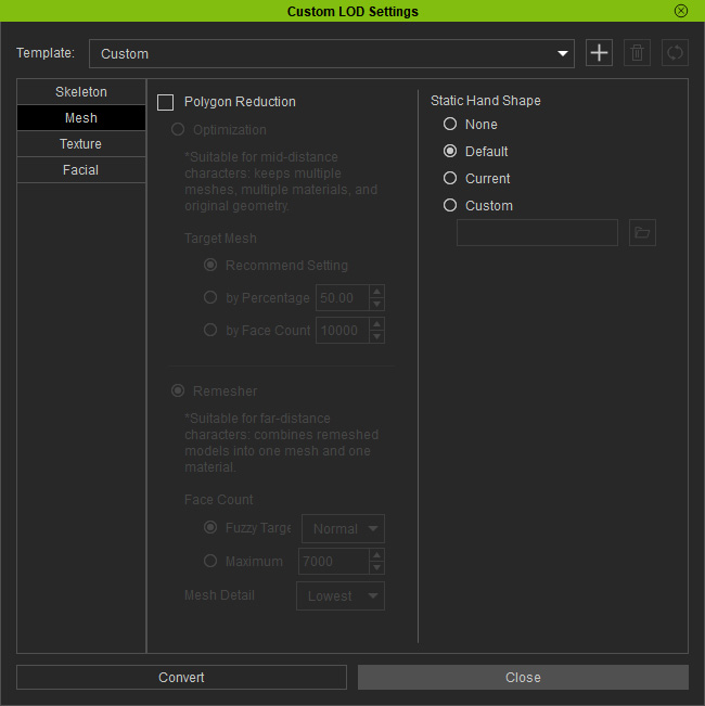

MeshYou can use the settings in this tab to decrease the face count of the character's mesh.
Optimization
- Suitable for mid-distance characters.
- The individual meshes are kept isolated.
- The mesh geometries are likely to be kept intact.
- You can optimize the face count with recommended settings (by percentage or by the specified face count).

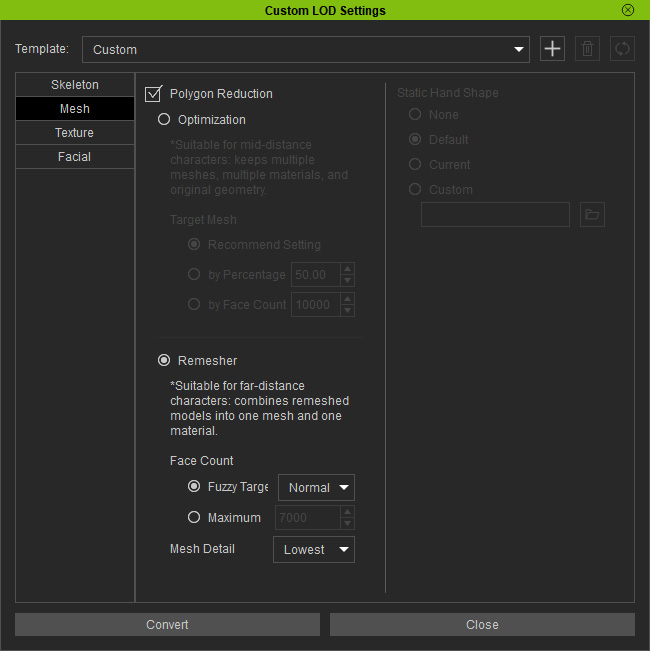

Remesher
- Suitable for far-distance characters.
- All mesh elements will be combined into one mesh.
- Merges all materials into one material.
- Face count will be decreased according to Fuzzy Target or specified maximum number.
- You can use the drop-down list keep details of the final mesh.
Static Hand Shape
- Choose the hand gesture when the finger bones are removed.
- None: Hand gesture of the bind pose. In most cases, this setting stretches out the fingers.
- Default: iHand gesture specified by Character Creator.
- Current: Bake to keep the current hand gesture.
- Custom: Load a file (*.iHand format) to determine the hand gesture after conversion.
- You need to deactivate at least one finger bone checkbox in the Skeleton tab before these settings are enabled.
