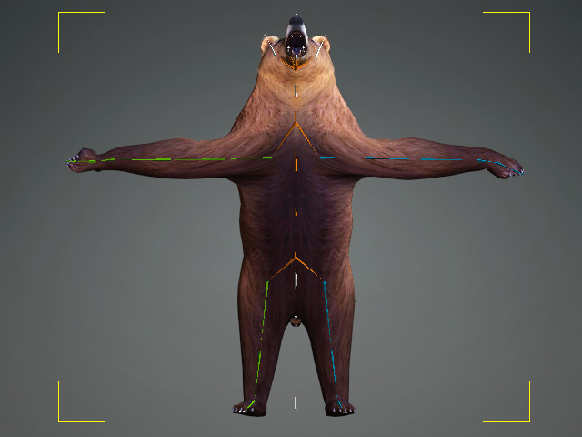

Load a prop or creature character (in this case, a Creature).
Click the Characterization button in the Modify panel.
Follow the tasks described in the Importing Bone-Skinned Models to Create Humanoid Characters section to finish the characterization.

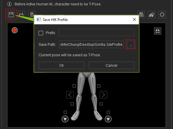

- Enable the Active box to enable the settings.
Click the Save button at the top of the characterization mode panel to save the mapping result
and T-pose as a profile (*.3dxProfile).

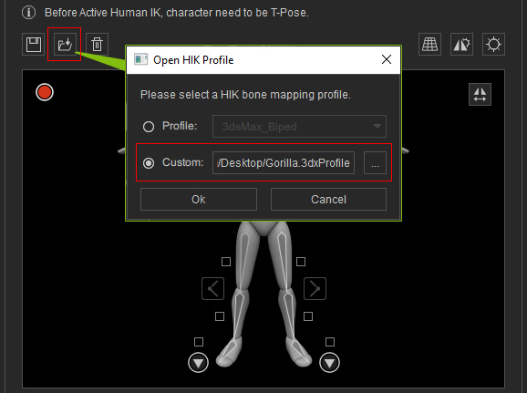

Create a new file, load another character with an identical bone structure as the current character.
Click the Load button and load the profile you have saved.

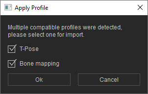

- Activate the T-Pose and Bone mapping checkboxes to apply the data from the profile. Click the OK button.
The custom character will then be instantly characterized and ready for being converted into a humanoid character.
