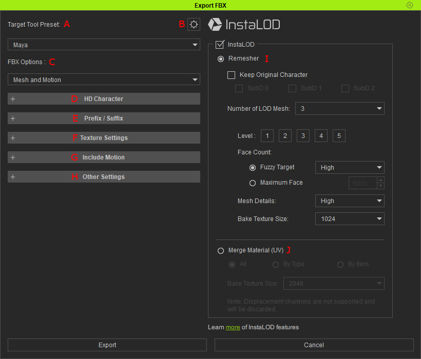

The Export FBX panel shows:
- Target Tool Preset: Use the drop-down list to determine the target 3D tool into which you want to load the FBX file.
- Advanced Settings: There are advanced settings that will be automatically set after you select different Target Tool Preset.
- FBX Options: You can use the drop down list to determine if you want to export Character, Motion or Character with Motion FBX files. In this case, set it to Mesh for exporting a static character.

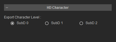

- HD Character: Choose the subdivision level for exporting the character.

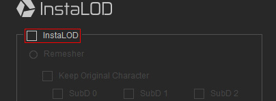

Notice that the InstaLOD checkbox in the panel must be deactivated to enable the options in this section.for exporting the character.

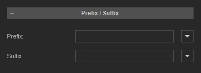

- Prefix / Suffix: These setting can be used to add prefix or suffix to the file name.

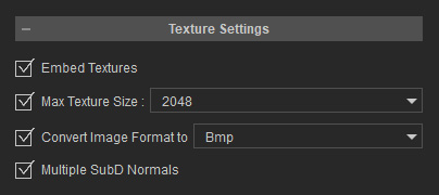

- Texture Settings: Use the settings to determine the texture size and format. To include normal maps in different subdivision level, activate the Multi Level Normal checkbox.

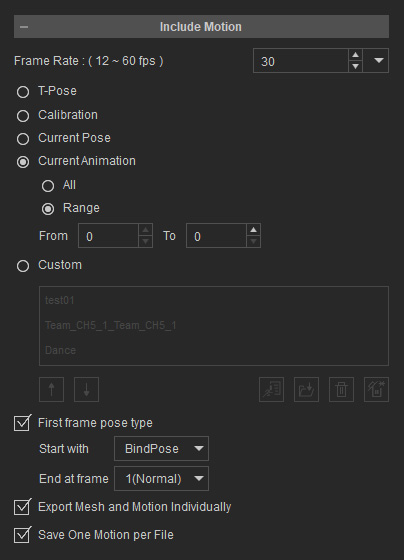

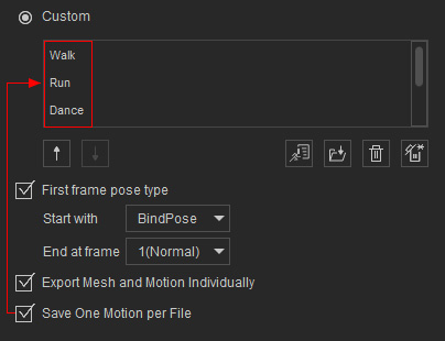

- Include Motion: You are able to append motions (Calibration Motion, iMotion, MotionPlus) into the exported FBX. If you choose the Export Types to Mesh only, then the settings in this section will
all be disabled.
- First Frame Pose Type: Defines the pose used on the first frame of the FBX animation.
- Start With: Choose whether to start with the Bind Pose (default rig pose) or T Pose.
- End at Frame: Sets the final frame for export. Use 1 (Normal) for standard export or 60 (Physics) to include physics simulation results.
- Export Mesh and Motion Individually: Exports the character mesh and animation as separate FBX files.
- Save One Motion per File: Exports each motion in the Custom list as its own FBX file. This checkbox is only enabled when there are multiple motion entries in the Custom field.

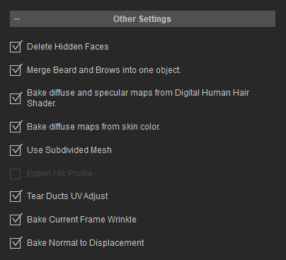

- Other Settings:
- Delete Hidden Mesh: Activate this box to delete the hidden meshes to downsize of the FBX file. If your purpose for exporting FBX character is creating custom cloth, then please do not activate this box to ensure the integrity of the inner meshes.
- Merge Beard and Brows into one object: To merge the beard and brows elements of the Smart Hair into one object.
- Bake diffuse and specular maps from Digital Human Hair Shader: To bake the diffuse and specular maps in the Digital Human Hair Shader for 3D tools, excluding Unreal.
- Bake diffuse maps from skin color: To bake the skin color onto the diffuse map to ensure the correct skin color in external 3D tools.
- Use Subdivided Mesh: Export the object with subdivided meshes to have smoothed surfaces in other 3D tools.
- Export HIK Profile (for Humanoid character): When exporting a humanoid character as an FBX, an HIK Profile will also be saved and used by Characterize when returning to Character Creator.
- Tear Ducts UV Adjust: Adjusts the UV coordinates of the tear duct area to ensure proper alignment and seamless texture blending with the surrounding eye region.
- Bake Current Frame Wrinkle: Captures the wrinkle details from the current animation frame and bakes them into a static texture map for consistent rendering or export.
- Bake Normal to Displacement: Converts the detail information from a normal map into a displacement map, enabling true geometric surface deformation based on the original normal details.
- Remesher: These settings are used to re-build the meshes to downsize or create LOD effect for the FBX file. However it's a destructive process since topology will be altered after the model has been remeshed.
- Merge Material: These settings can be used to merge materials for downsizing the FBX file.
- Click the Export button to export the objects in FBX format.

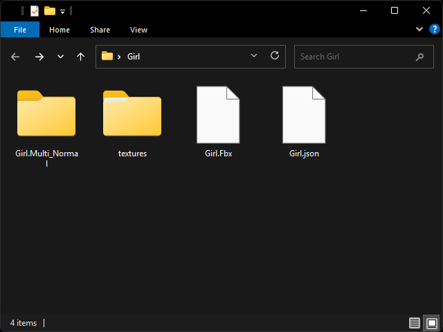

You will obtain data as shown in the following illustration.
- 'Multi_Normal' folder: Contains normal maps used for different subdivision levels.
- 'textures' folder: Stores all texture maps in categorized subfolders, including metallic, roughness, etc.
- json file: A data file that records the relationships between objects and their textures.
