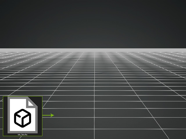

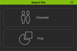

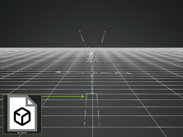

Load a desired FBX motion file by drag-and-dropping the file directly into the 3D viewport.
- Click the Character button in order to start generating a character.
- Click the Humanoid button to create a humanoid character
and click the Apply button.

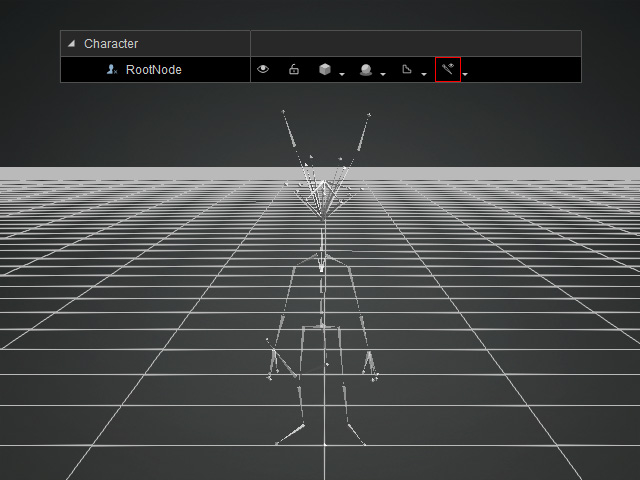

- If the file contains no character mesh, then
show the bone in the Scene Manager for observation.
Character Creator will enter the Characterization mode automatically.

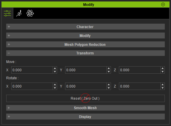

NoteIf the character is offset from the floor, then exit the Characterization mode and adjust the X, Y, Z values in the Transform section so that the motion will be relocated to the center of the world coordinates. *You must not use the Reset (Zero Out) button to change the position of the motion.
Make sure you re-enter the Characterization mode after the transformation.

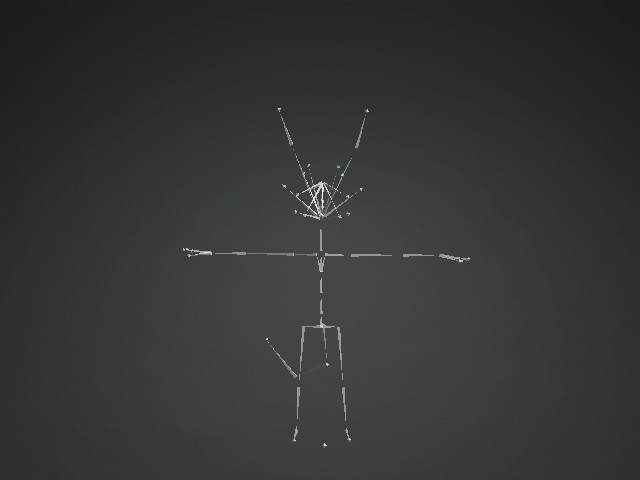

Step 2: Setting T-Pose
Because all iClone motions (*.iMotion) are based on the T-pose, then you must adjust the motion's pose to a T-pose so that you will not encounter any offset issues in the body parts once you apply these motions.
If the character does not appears in T-pose after previous step, then you must manually set the T-pose for the character.

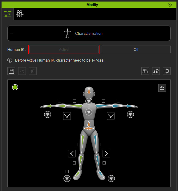

- Make sure that Character Creator is in the Characterization mode and the Active checkbox is not activated.
- Manually set the T-pose for the character.

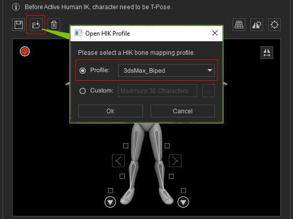

FBX from Standard Bone-rigging 3D ToolsIf you know the 3D tools from which your FBX file were created, then you only need to select a prepared profile with completed mapping results and T-pose.
Please refer to the The Concept of Converting to Humanoid Character and the Auto Bone-Mapping Method sections for more information.

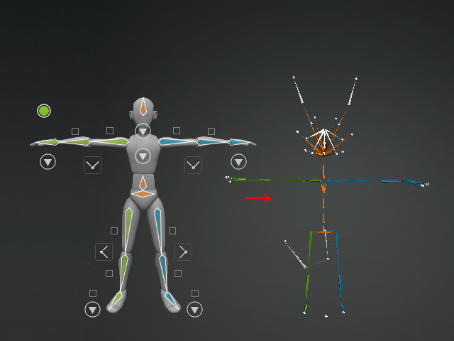

FBX from Unknown 3D ToolsIf the FBX is from unknown 3D tools, then manually map at least 15 basic bones of the Standard Character Bones to the corresponding bones of the loaded motion.
(The dummy image of the bone structure on the right side of the application is the RL Bone - Reallusion Bone Structure).

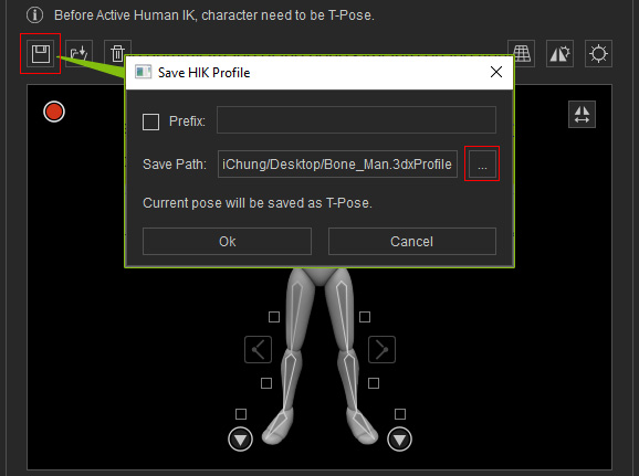

Please refer to the The Concept of Converting to Humanoid Character and the Custom Bone-Mapping Method sections for more information. - Save the T-pose and Mapping Result to a profile (*.3dxProfile).

After finishing with the mapping, click the Active button so that the
non-mesh Humanoid character is created.

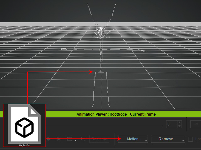

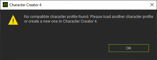

Exit the Characterization mode by pressing up the Characterization button. - Drag-and-drop the same FBX file to the character.
Click OK on the warning message.

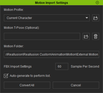

Characterize the motion with the following panel.
- Motion Profile: If you know the source tool of the FBX, then choose from the drop-down list, otherwise, choose Current Character; you can also click the load button to load the 3dxProfile file saved in previous step.
- Motion T-Pose (Optional): You can optionally load an FBX or BVH file with T-pose instead of using the custom one saved in the 3dxProfile.
- FBX Import Settings: Set the sampling rate by type in a desired number. The higher the number is, the more details of the motion will be kept.
- Auto-generate to perform list: Activate this checkbox in order that the motion will not only be loaded to the character, but also be added to the perform list in the Animation Player.

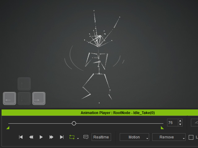

- The Animation Player will be enabled. Click the playhead once and press the Left or Right keys to check out the motion one frame at a time.

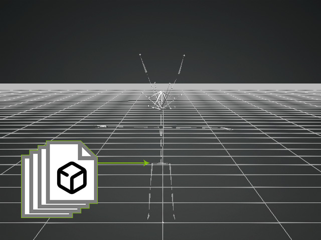

*You can drag-and-drop multiple motion files to the character if they originate from the same 3D tools.

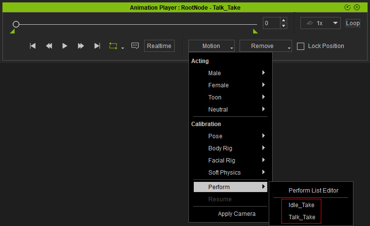

Step 5: Find Motions

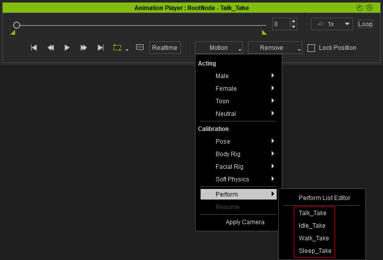

- After all motions are imported, you can find them in the Perform List in the Animation Player.

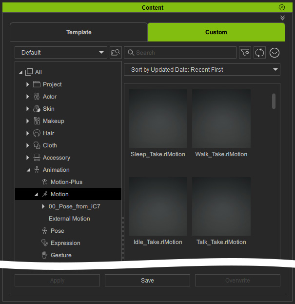

- Go to the Smart Content Manager, you can also find these converted motions (in rlmotion format) in the Animation Library.
- These motions can be applied to any Standard or Humanoid character in Character Creator and iClone.
