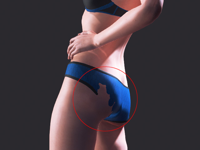

Fixing Poke-through
Method 1

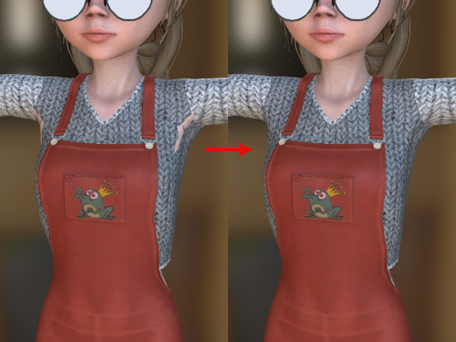

Use the Transfer Skin Weight feature to re-assign the skin weight to fix the issues.
Before |
After |

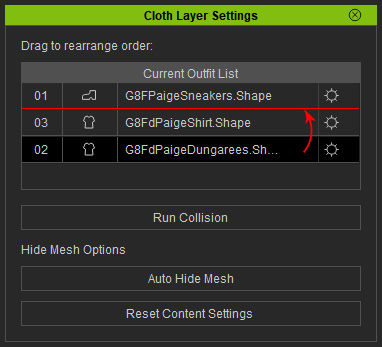

Method 2
Re-order the layer of the clothes with the Cloth Layer Settings panel; you can launch the panel from the Modify menu.
Click the Run Collision
button on the panel to remove the poke-throughs.
