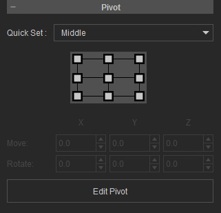

Set the pivot location

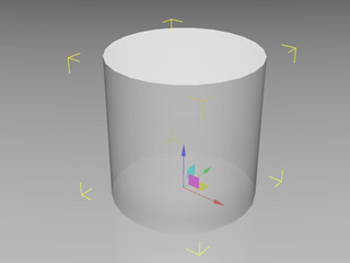

You might come across models that have eccentric pivots. In Character Creator, you may freely change the pivot of the selected P-o-A without the use of any external software.

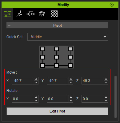

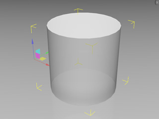

Please select the target P-o-A and toggle the
Gizmo mode to view the position of
the pivot. And go to the Pivot section under its attribute tab in the Modify panel.|

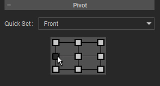

Using Quick Set

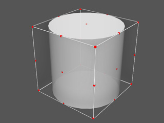

Each P-o-A is surrounded with a bounding box which shows the height, the width and the depth range of the P-o-A.
There are 27 fixed points located on the bounding box for quickly
setting the pivot location.

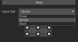

Select a P-o-A and switch to the move, rotate or scale tool and turn on its gizmo.

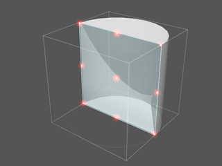

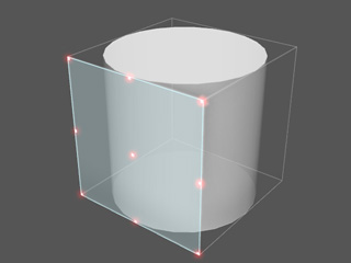

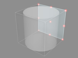

Use the drop-down list to decide which intersect plane of the bounding box you want to use.
Front intersected plane
Middle intersected plane
Back intersected plane
Click on one of the nine points to re-locate the position of the pivot.

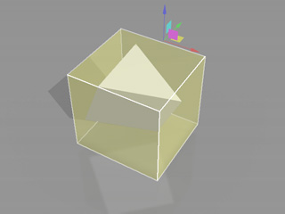

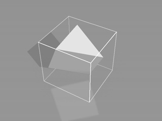

Note:Do not rotate a P-o-A and then set its pivot with Quick Set feature. Because this feature always sets pivots according to a straight virtual box that fits the P-o-A, which can mess up the pivot's position.
A rotated pyramid and a box surrounding it.
Back >> Top is set to the pyramid according to the box's orientation.

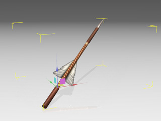

Click the Edit Pivot button. You will see that the pivot of the P-o-A
may be eccentric as the illustration shows below.
Use the Move
tool to relocate the pivot to the desired position of the P-o-A.
Alternatively, you may enter exact values for relocating the position of the pivot.

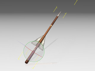

- Since the pivot's orientation is always local, then use the Rotate tool to align the
pivot orientation to the P-o-A.
Before adjustment
After adjustment
Click the Edit Pivot button again to leave the editing mode.
