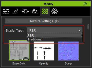

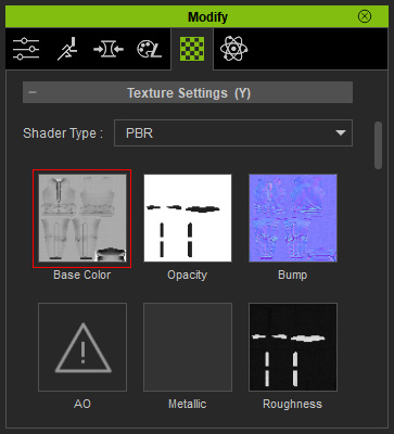

In the Texture Settings section, change the Shader Type to PBR.
The Specular and Reflection channels (effectiveless in PBR) will be changed to Metallic and Roughness channels.

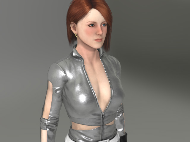

Compare the look before and after it is converted to PBR shader type.

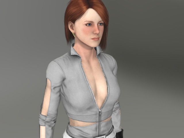

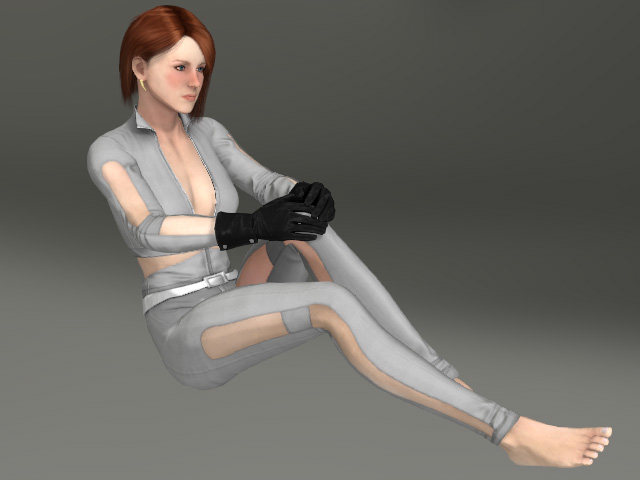

Traditional shader type.

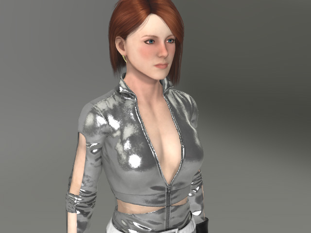

PBR shader type: Reflects the lights from the IBL environment to make the object more realistic.

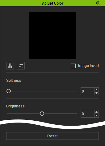

Select the Metallic channel and click the Adjust Color
button to show the corresponding panel.
Adjust the Brightness slider to change the level of the grayscale Metallic texture to determine
if the object is more like metal or non-metal (in this case, the value
is increased to make the material more metallic).
- Select the Roughness channel.
Adjust the Brightness slider to determine the roughness status of the surface for the object
(in this case, the value is increased in order to grind the surface of
the object).

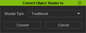

Instead of multi-selecting these materials in the list for converting them
to PBR shader type, click the Convert Object Shader
button

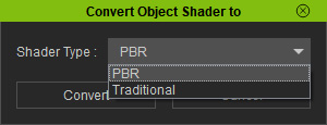

to display the corresponding panel.
Set the Shader Type drop-down list to PBR and click the Convert button.
All materials on the list will thus be converted into PBR shader types.

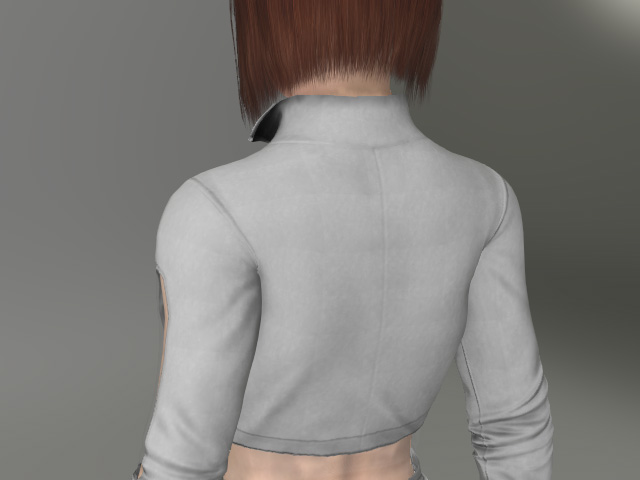

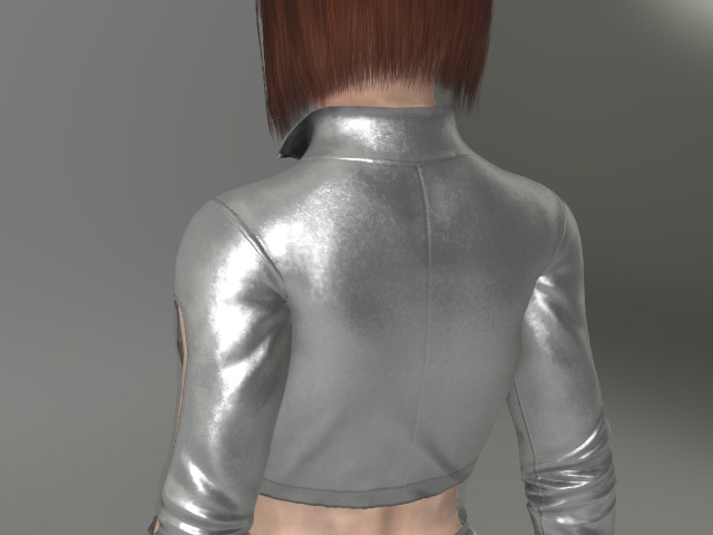

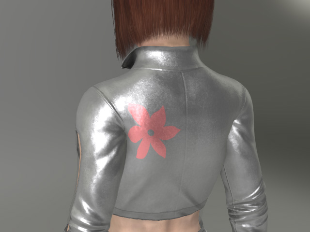

PBR shader type.

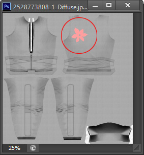

In the Modify panel >> Material tab >> Texture Settings section, select the
Base Color channel and click the Launch
button to export the texture to an external image editor (in this case, Photoshop).
Modify the texture in the editor.
Save the texture file to pass the modification back to the Base Color channel.

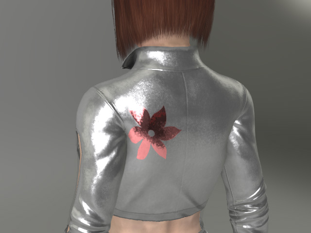

Select the Metallic channel and then follow the same steps to modify the texture of the channel.
Please note that the white part is complete metal and the black part is totally non-metal.
Select the Roughness channel and then follow the same steps to modify the texture of the channel.
Please note that the black part is complete smooth and the white part is totally rough.
Optionally adjust the Normals texture (given the proper
technique).
Modify the normal texture to emboss the print.
