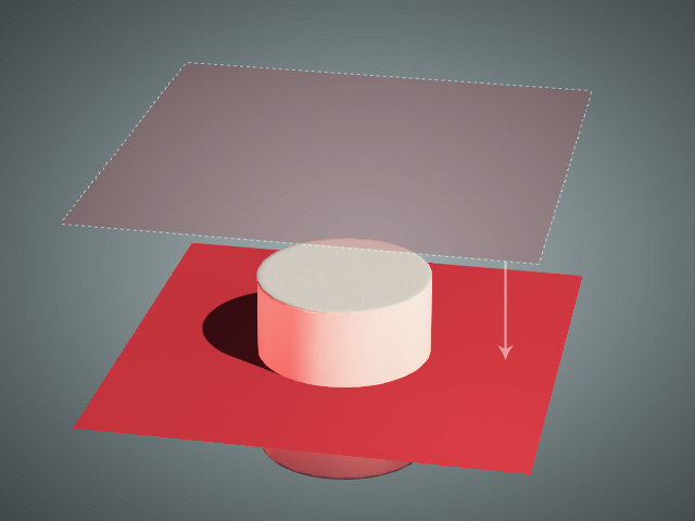

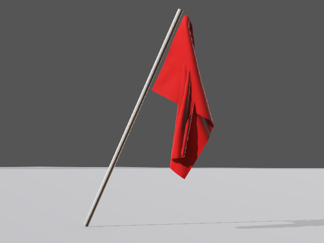

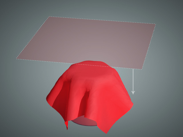

Soft vs. Rigid Collision & Self Collision
These settings must be enabled if you want a specific soft-cloth to interact with other rigid bodies or with itself. Otherwise the soft cloth will penetrate all rigid bodies or its own mesh when it is animating.
When these settings are on, more system resources will be consumed; therefore, disable them when soft-clothes are isolated from all other rigid bodies.
Soft vs. Rigid Collision = Off
Soft vs. Rigid Collision = On |
Self Collision = Off
Self Collision = On |

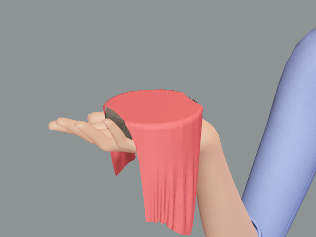

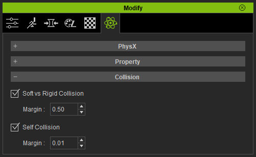

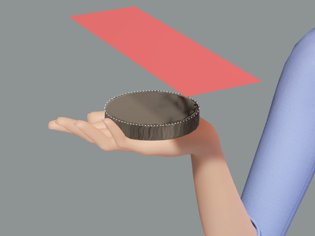

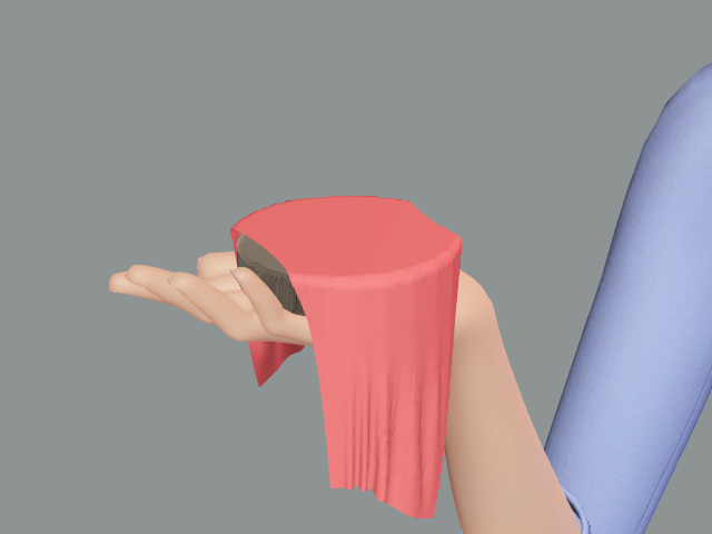

Collision Margin
Collision Margin is the reaction range from the surface of a soft cloth during collision. The higher the value, the farther away from other objects the collision will take place. This is useful especially when the sharp edges of the target object (mostly rigid bodies) go through the soft-cloth.
Collision Margin = 0.20 |
The soft-cloth closely covers the rigid body shape. |

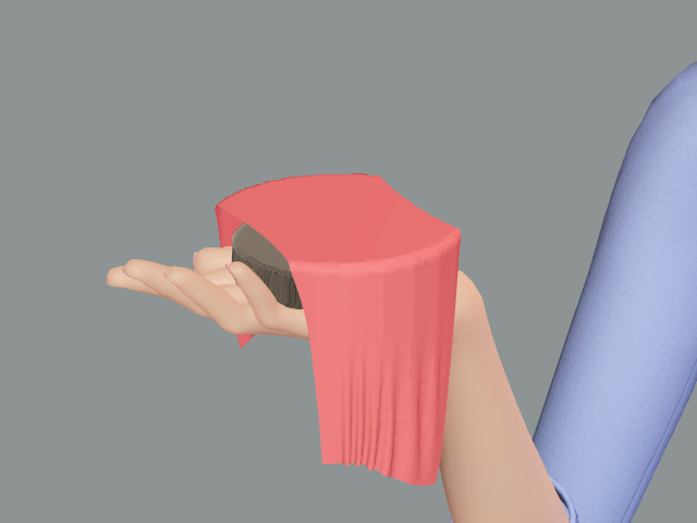

Collision Margin = 0.60 |
The soft-cloth moves slightly away from the surface of the rigid body. |
