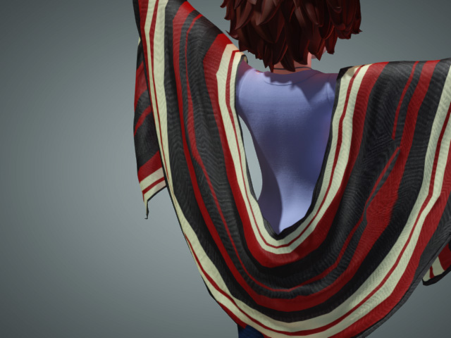

Stretch = 90 Bending = 2 Solver Frequency = 60 (Fewer animation details - silk) |

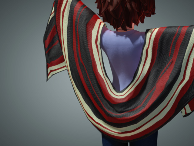

Stretch = 90 Bending = 2 Solver Frequency =1200 (More animation details - rubber) |
