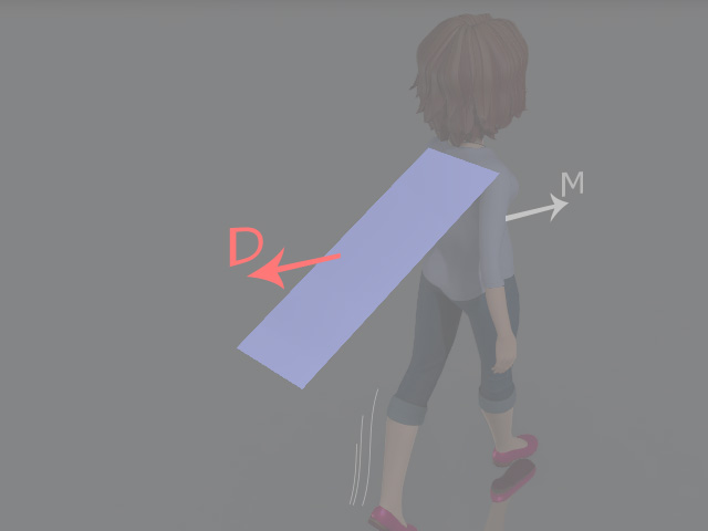

The component of force parallel to the oncoming flow is called Drag.
It will essentially pull the soft-cloth towards the opposite direction (D)
of the initial momentum (M).

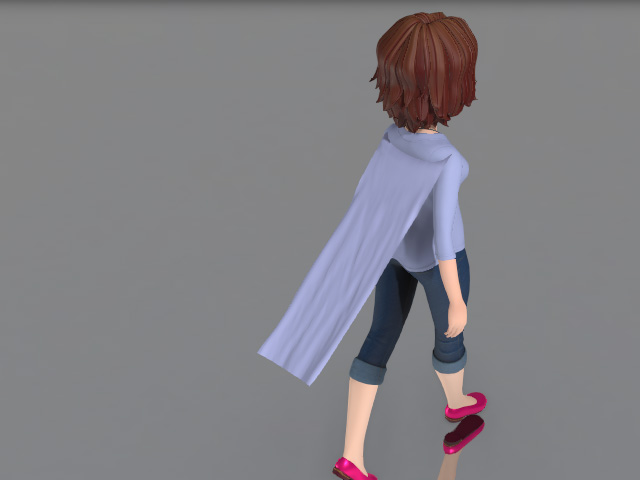

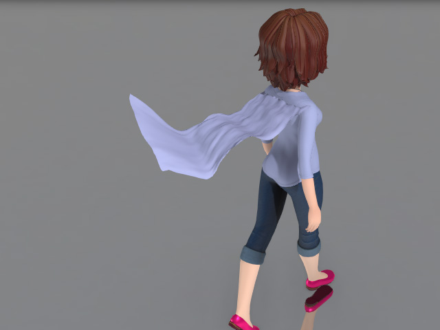

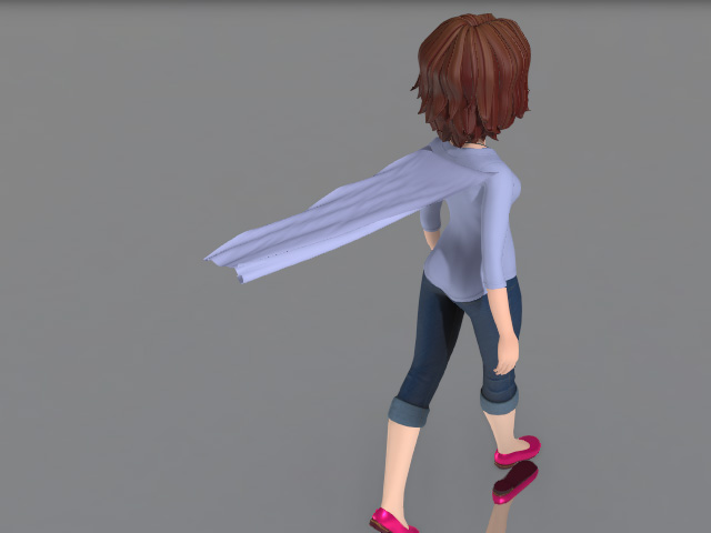

Drag = 0.20 Weak dragging force. |
Drag = 1.00 Strong dragging force. |
You can then mix-up this setting with a
Wind force to produce a turbulent and extended soft-cloth.
