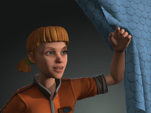

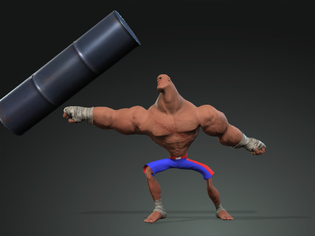

Once the character is given physics settings, it is able to interact with any other physics objects. The collision animations between the characters and the rigid body or soft clothes will be automatically generated.
Character interacting with Rigid Body. |
Character interacting with Soft Cloth. |

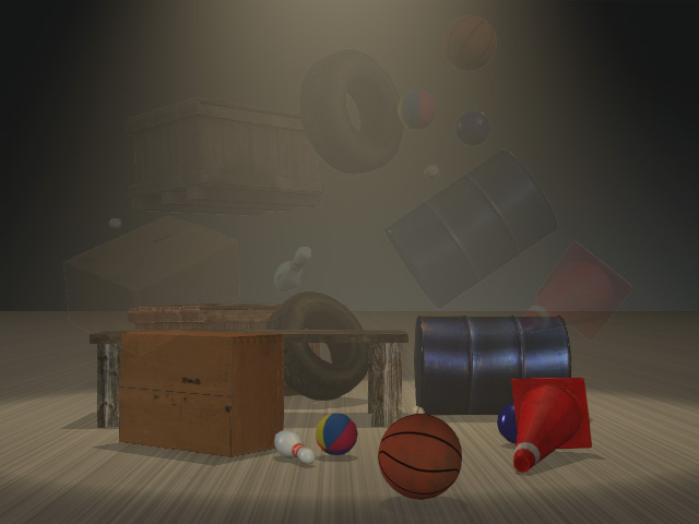

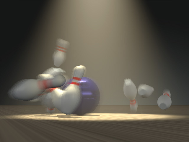

Rigid body dynamics enable you to simulate objects with a high degree of realism such as fall, collide and bounce. All these movements are controlled by physics properties such as mass, elasticity, friction, damping, impulse, collisions, constraints and others. You can even add rigid body physics to any prop or character in order to add another dimension of interactivity between subjects.
Rigid bodies fall by nature. |
Rigid Bodies interacting with each others. |
