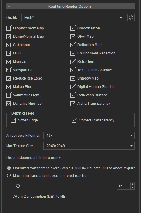

Real-time Render Options
Quality
The Quality drop-down list contains different modes to turn on/off certain effects in the viewport in order to release the hold of system resources.
High Mode: All effects are turned on. |
Medium Mode: Displacement, Smooth Mesh, HDR, Tessellation Shadow and Viewport GI are turned off. |
Quick Mode: Only the Bump / Normal, Substance, TAA and Shadow effects are turned on. |
Minimal Mode: Only TAA is turned on. |

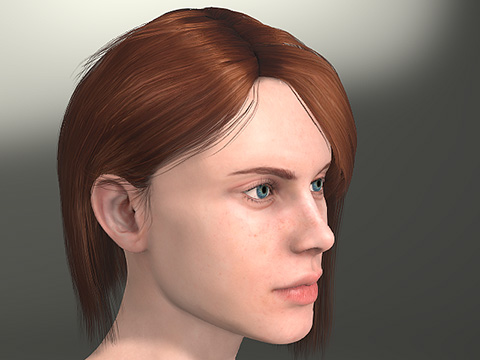

TAA (for Real-time Rendering only)
An advanced anti-alias technique (Temporal Anti-Aliasing) for the viewport can minimize jagged edges and pixelated areas. Activate the checkbox to turn on TAA (Shortcut: Shift + T). Real-time anti-aliasing starts to calculate only when the viewport is at a standstill.
TAA = OFF |
TAA = ON |

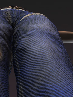

Mipmap
The Mipmap is used for gradually reducing texture quality as the object strays from the camera.
Mipmap Off |
Mipmap On |

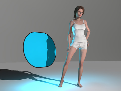

Viewport GI
When the GI main switch is turned on and the performance is negatively impacted, the Viewport GI Switch can be turned off temporarily to regain critical framerate. Toggling the view-port GI switch does not affect the GI for final rendering.
You can also click the middle button on the GI Toolbar for turning on or off the viewport GI effect.
Viewport GI = OFF |
Viewport GI = ON |

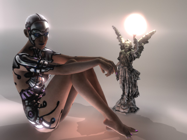

Depth of Field
This group contains two settings that can be used to remedy rendering artifacts in the 3D viewport for DOF. However, activating them increases the consumption of the system resources. Please refer to the Fixing Visual Defects of Out-of-focus Objects section for more information.

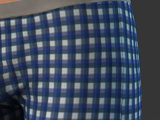

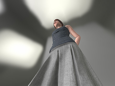

Anisotropic Filtering
As the camera angle becomes too oblique, MipMap feature may cause some surfaces that are nearer to the camera to blur. To compensate for this, you may increase the Anisotropic Filtering value to preserve texture quality.
Anisotropic Off |
Anisotropic = 16x |
