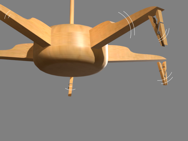

By adding spring effects to specific parts of a prop, the resulting bouncing effects result in a more dynamic and realistic animation. This pipeline is suitable for any bone-skinned model from other 3D tools or merged models constructed in iClone.

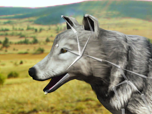

Load a model
with a bone-skinned structure in iProp or FBX formats. The
following model comes from the
Wild Animal Content Pack by Reallusion.

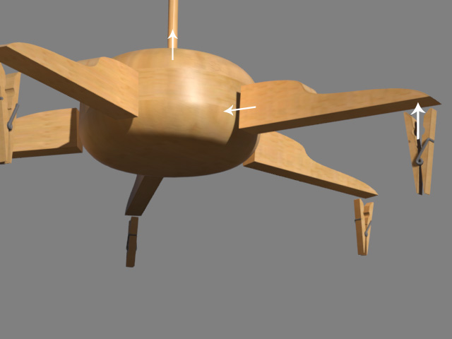

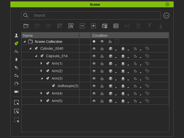

Build Structured Props in iClone
Attach each transformed (or not transformed) part to
single main root prop.
Sequentially attaching.
The structure in the Scene Manager (Single root only).

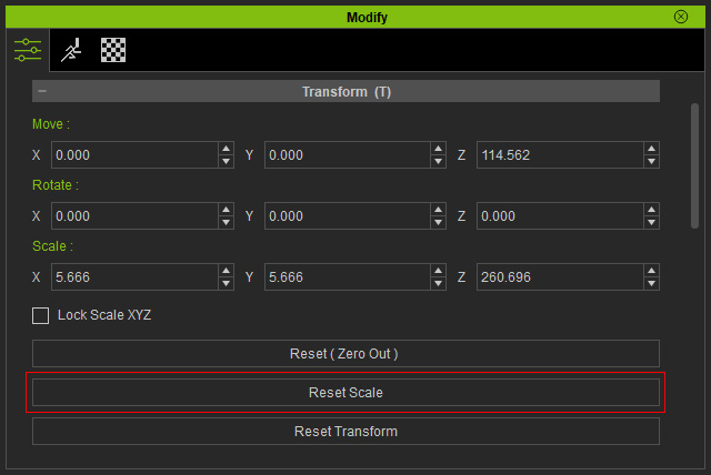

- Select the root prop and scroll to the Transform section in the Modify page.
Click the Reset Scale to initialize the size for all sub-nodes to prevent structure distortions.

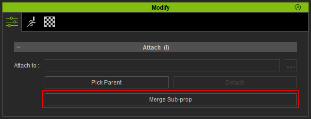

Scroll to the Attach section of the Modify panel. Click the Merge button.

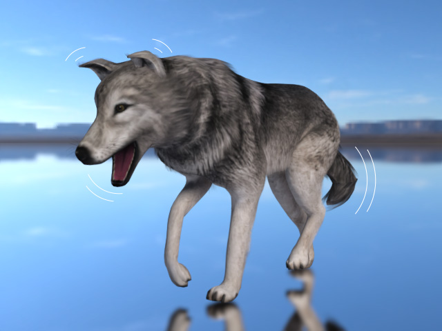

In this example, the head and the tail bones of the prop have been given spring effects.
- Export the entire model as one single prop (.iProp).
Load the prop into iClone. Animate the prop to view the spring effects

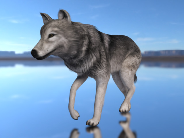

Without spring effects.
With spring effects.
