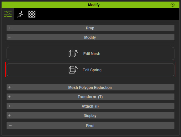

Before applying spring effects to a node, you need to perform the following parameter adjustments:
Load a model with a bone-skinned structure (character or prop).

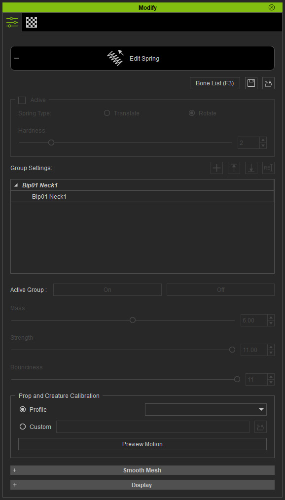

Click the Edit Spring button in the Spring section.
The Modify panel will switch to Spring Editing mode.
Select one or more bones to which you want to apply spring effects.

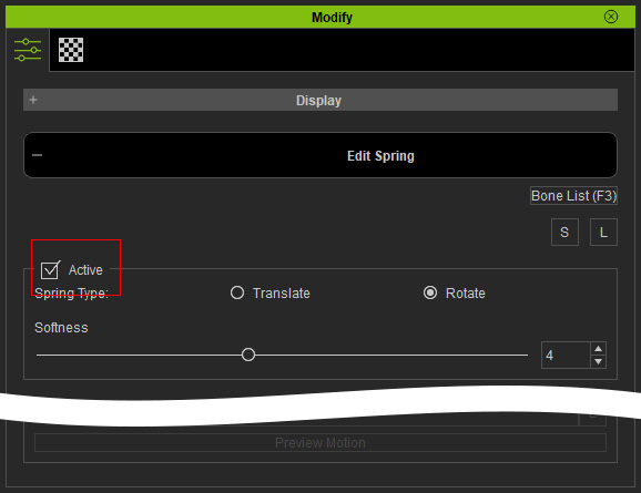

Click the Active checkbox
Translate and Rotate

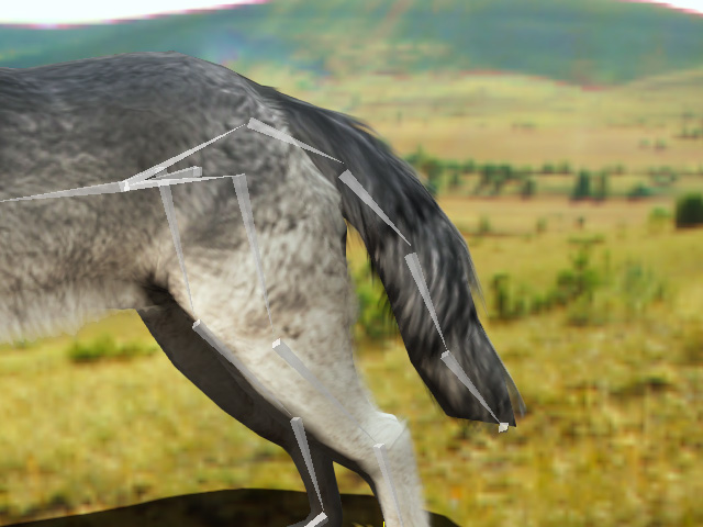

The spring type can be set to Translate or Rotate, which determines the bounciness for the nodes. *The result will be unpredictable if you apply a mixture of Translate and Rotate values to different nodes in a group.
- Translate: when you want the nodes to exhibit a dramatic spring effect such as stretch or offset, then
you may select this radio button. The nodes will depart from the entity along with its movements.
Spring effect - Translate.
- Rotate: Select this radio button to set rotate spring effects such as waving or whirling.
This setting keeps nodes as firmly connected as possible while they rotate around.
However, when the mass is high or the node value is set rather soft, it might still show some offset.
Spring effect - Rotate.
Note- The levels of the color indicate the strength of the Soft / Hard as described in the next section.
