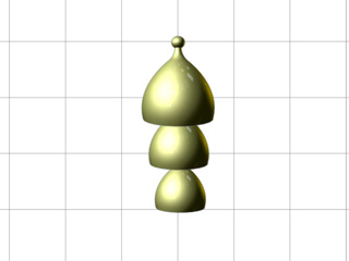

  1. In Stage Mode, select a prop and save it into the prop library.
  2. Switch to the Prop Composer mode.

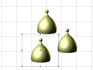

  3. Search for the sprite in the library you saved in Step one. Drag and drop it into the working area twice.

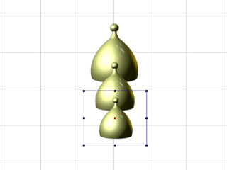

  4. Move, rotate or scale the sprite to the appropriate position.

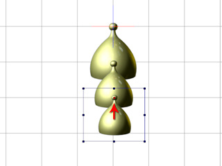

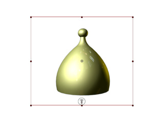

  5. Set the pivots for each sprite to the right place for correct rotation.

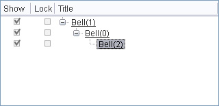

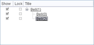

    The hierarchy in the Scene Manager:
  6. Use the attach tool to set the sprites into a tree structure.

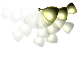

  9. The motion of the chained prop can now be set using the Prop Key Editor (shortcut: K) on the Property Bar.
