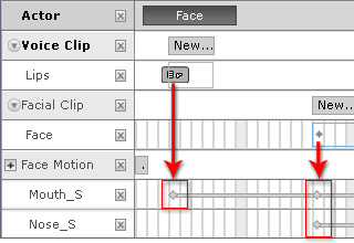

Switch: When you use the Sprite Editor in stage mode to manually replace the elements in a sprite, then you are setting a replacement key (also known as a Switch). As the project plays up to the time frame where the switch occurs, then the previous element will be replaced with the designated one.
Switch Mark: Switch marks are tokens representing the sprite switch timing, governed by it's master clip (from Voice Lip Synching, Puppeteering) or motion key (from Key Editor); it prompts you that there is a sprite switch key in other relevant tracks.
