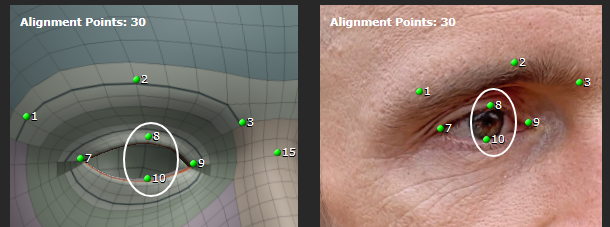

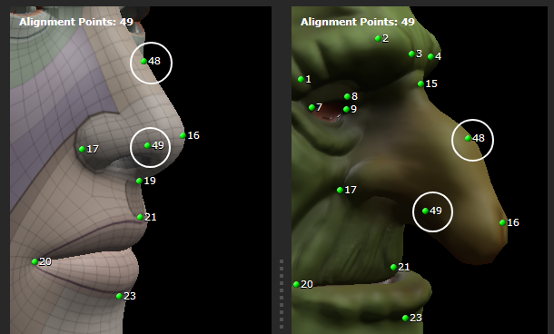

Comparison between appropriate and inappropriate alignment point order and positioning
Appropriate alignment |
Inappropriate alignment |

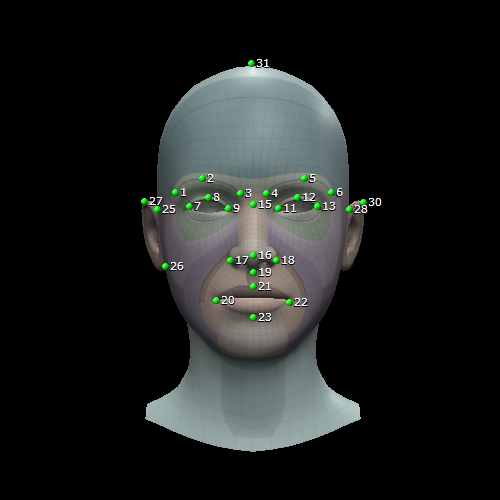

Point Deployment

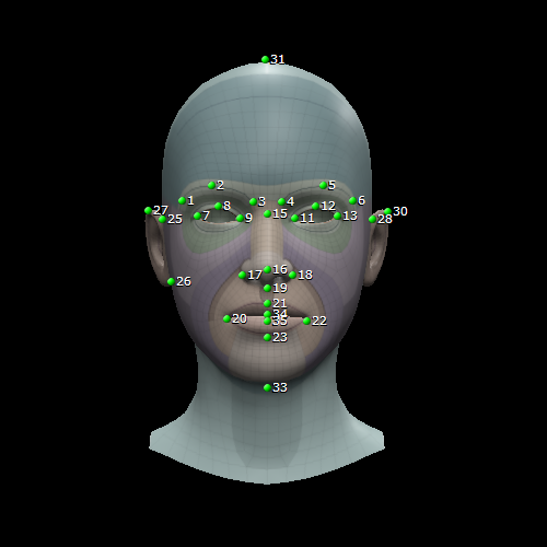

For the ALIGN POINTS stage, select a suitable default alignment point deployment option. When adding the points, strive to closely match the positions of points in the two viewports to achieve best results.

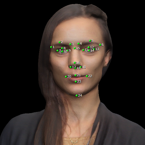

- 24 Points: For face-only mapping.
Before
After

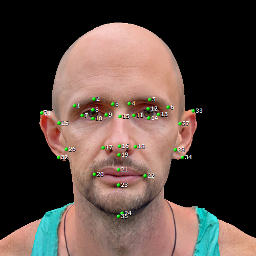

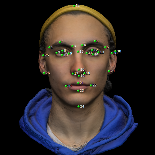

- 32 points: For mapping the face and the ears.
Before
After
- 35 points: For mapping the entire head including the neck.
Before
After
For a smooth and stable result, it is advisable to use a minimum of 24 points for your model. This ensures coverage of the essential facial features required for accurate generation.

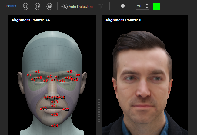

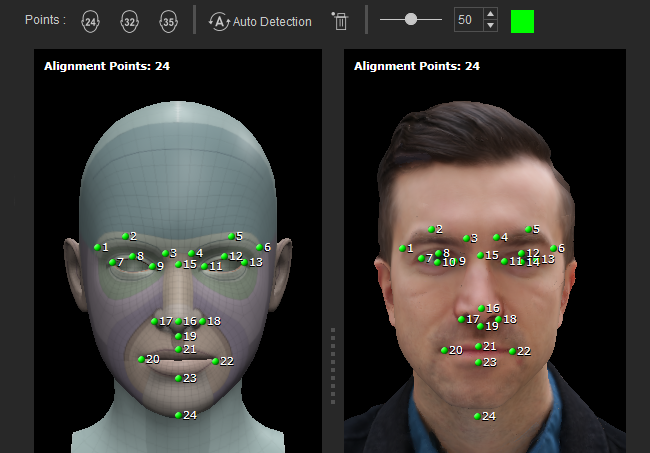

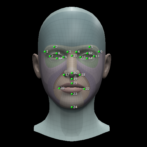

Auto Detection
Use Auto Detection to deploy 24 points to the mesh to map the areas around the face.

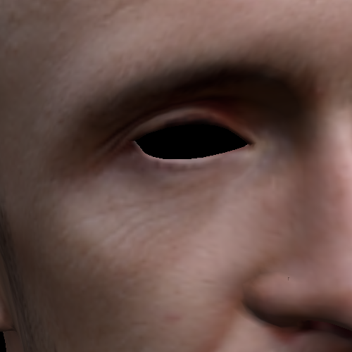

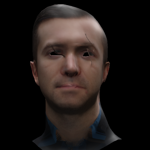

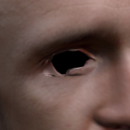

- Before Auto Detection
- After Auto Detection
Errors may arise with this feature if the provided mesh model deviates significantly from a human likeness or has exaggerated facial features. In such cases, manual adjustment of the points to their correct positions will be necessary. For detailed instructions on rearranging points, please consult this page.

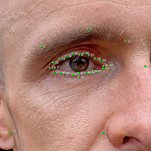

Points Quantity and Spacing
Avoid placing too many points close to each other as it does not improve the results and can confuse the shape detection software, resulting in worse outcomes.
- Correct
Before
After
- Incorrect
Before
After

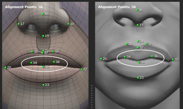

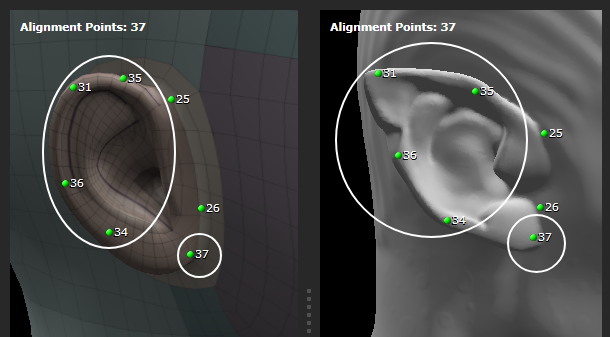

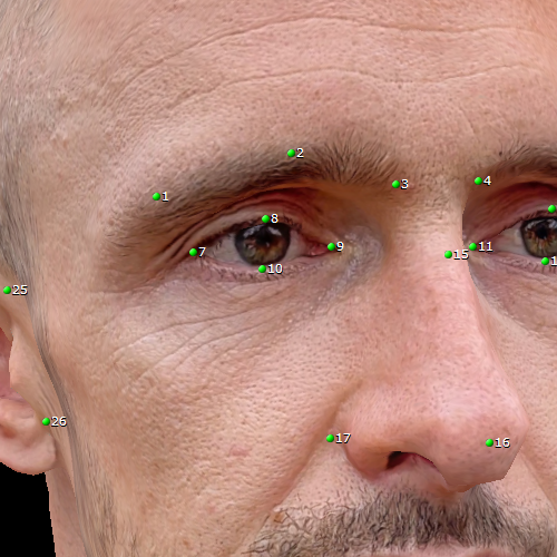

Use the Select tool to add additional points to the model as needed, particularly in areas with intricate features such as the eyes, ears, nose, and mouth.
- Eyes
- Ears

- Mouth
