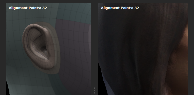

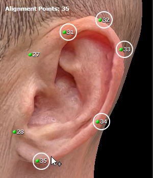

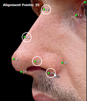

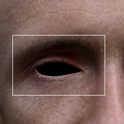

Adding additional points
By adding additional alignment points to compensate for the delicately and uniquely shaped features of your mesh, such around the ears and nose, you aid in Headshot 3’s ability to model fit accurately. To add alignment points on your model, hover over the mesh until a “+” sign appears. Left-click to add an extra point.
Before
After

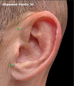

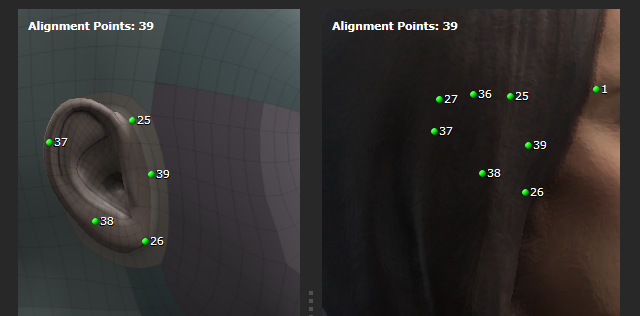

  • Adding Points for Ears
    In the following example, adding additional alignment points helps to achieve a more accurate representation of the ear.

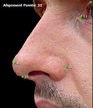

  • Adding Points for Nose
    In the following example, adding additional alignment points helps to achieve a more accurate representation of the nose.

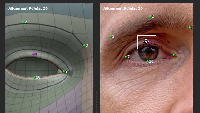

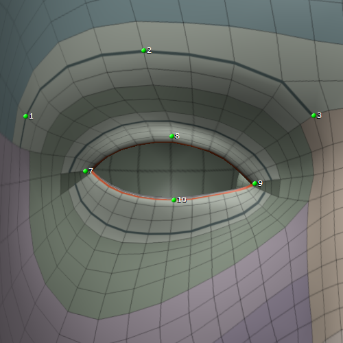

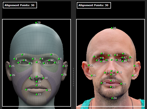

Moving existing points
By correctly positioning the points, the final result of the generated head shape will closely match your imported mesh. When the cursor hovers above existing points, the color of the point will change to purple and a move icon will appear. This indicates that you can move the alignment point to a different position.
  • Proper Point Positioning
    When the points are correctly positioned the generated result in HEAD GEN will be accurate and precise.
    Neutral head reference
    ALIGN POINTS
    HEAD GEN

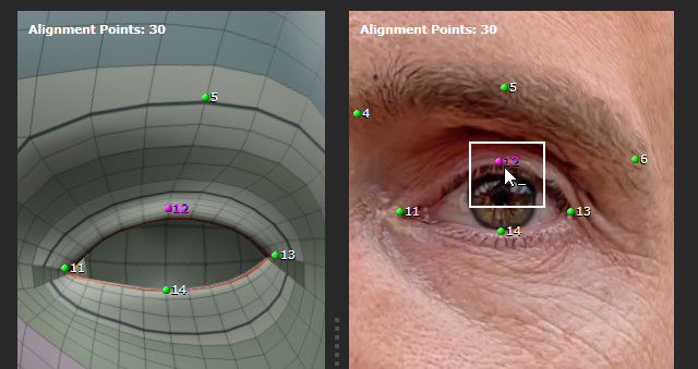

Removing Existing Points
Remove excessive points if their quantity becomes excessive, as having too many points does not necessarily enhance the final result. Moreover, if certain areas are obstructed or damaged, it is recommended to remove points in those specific areas as they are not crucial for the subsequent process.
When the cursor is placed on a point and the Ctrl key is held down, the point will turn purple, and a "-" sign will appear. This indicates that the selected point can be removed.
Before
After

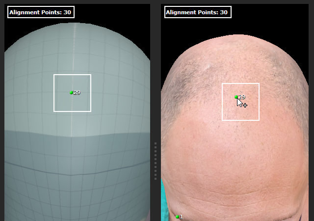

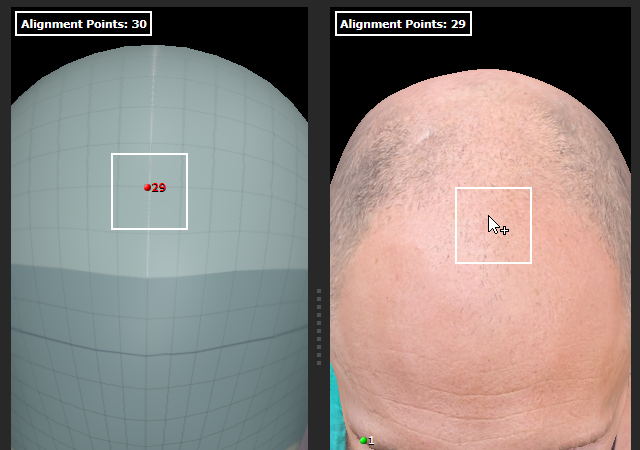

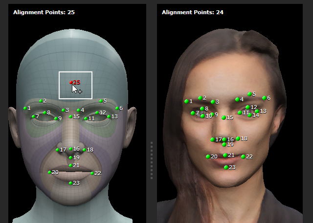

Alignment Points and Matching Numbers
When adding or removing points, ensure that there is an equal number of alignment points in both models. If a point lacks a corresponding point, it will be marked in red, and you will need to resolve it by adding or removing points before proceeding to the next step.
