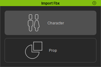

- Drag and drop the FBX file into CC
- Click the Character button.

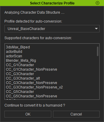

- Choose "Unreal_BaseCharacter" from the
Profile detected for auto-converstion drop-down list and click the
OK button to start characterization.
