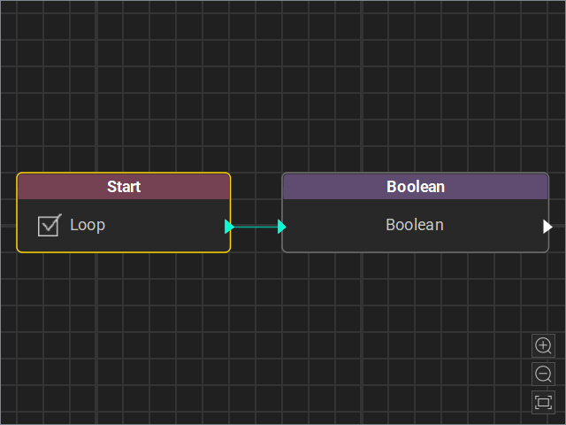

  3. Open the MP Node Graph panel. Right-click on the viewport space and choose Print Node > Boolean.
    A new Boolean node will be inserted on view.
  4. Drag a flow line from the Start node’s output and connect it to the Boolean node’s input.
  5. Select the node and adjust the settings in the Attributes page.

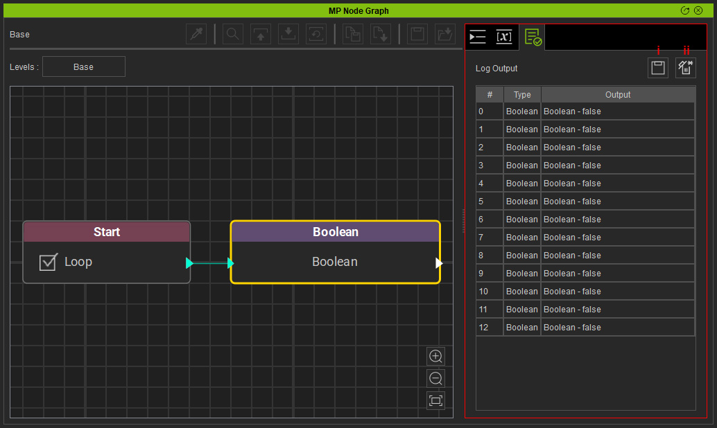

  6. Optionally activate the Loop setting of the Start node.
  7. Start the Go MD Mode to view the animation results.
  8. You can switch to the Log page to view the Log Output obtained by the Node. The emitter also displays the string from this list.
    1. Save Log: Save the log as a file (*.txt).
    2. Clear Log: Clear the data in the Log Output list.
