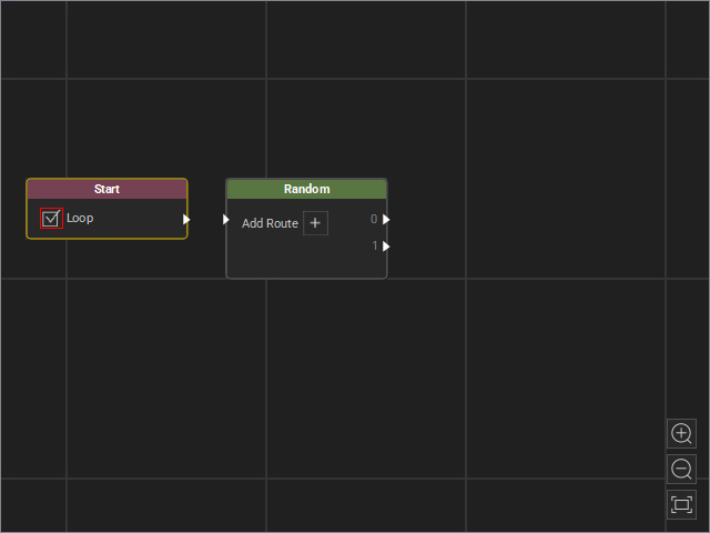

  2. Open the MP Node Graph panel. Right-click on the viewport space and choose Flow Node > Random.
    A new Random node will be inserted on view.
    Enable the Loop option on the Start node to play back the graph repeatedly in Go MD mode.
  3. Drag a flow line from the Start node’s output and connect it to the Random node’s input.
  4. Click the + button specific times to add outputs.

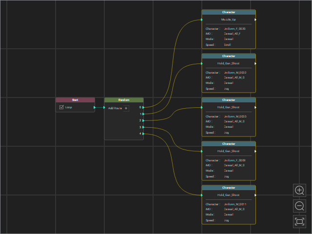

  5. Connect the outputs to different event routes.
    Note that these events routes are Character Nodes that drive the individual characters on stage to perform specific motions.
  6. Start MD Mode to view the animation result, the characters randomly perform motions in turn.
