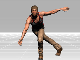

Using the Perception Neuron Plug-ins with Mirror Mode
By default, the character's body parts use the motion input from your body to move. Therefore, when the character is facing you and you move your right hand, the character will also moves its right hand, which can sometimes be confusing, especially when you need to interact with the props inside of the scene. For this you can work with the Mirror function.
Mirror = Off
Activate the Mirror box and then you may control the character as if using a mirror.
Mirror = On
