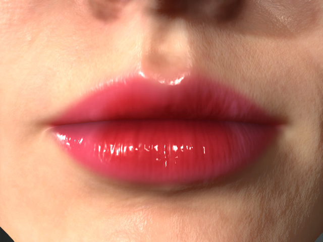

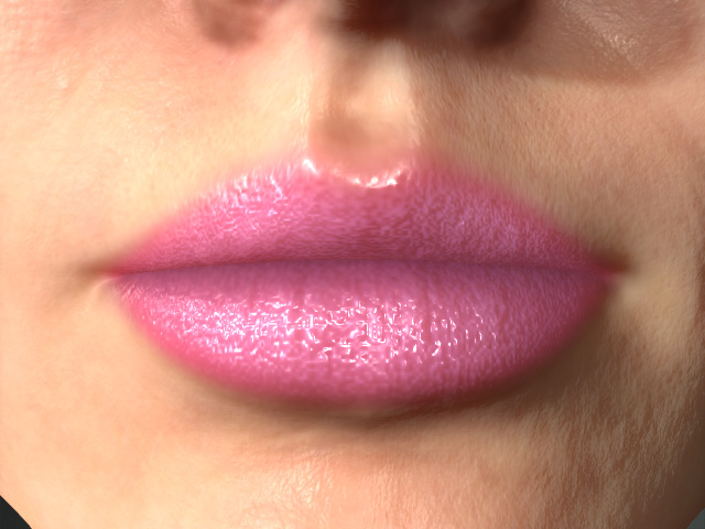

After the effect is applied:
Before the Lip Tool is applied |
After the Lip Tool is applied |

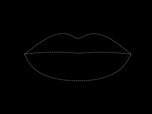

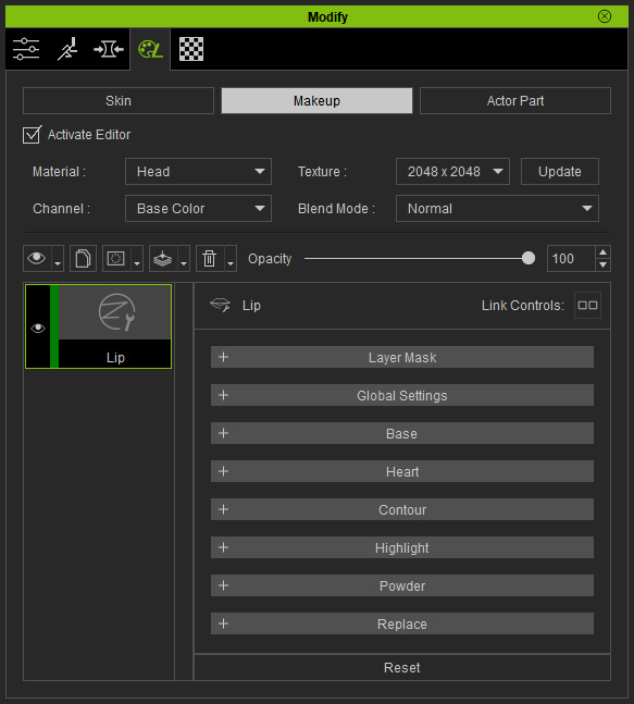

Regions on Lips
The lips are divided to four different regions: Base, Heart, Contour and Highlight.
It contains the mask for the entire layer to take effect.
The textures in this section can be edited if you have purchased
and installed the SkinGen Plugin.
Refer to the Layer Mask section for more information.

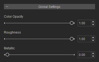

The settings in these sections adjust the entire color, smoothness and moisture of the lips.
- Color Opacity
Color Opacity = 1.00
Color Opacity = 0.50
- Roughness and Metallic
Roughness = 0.5
Metallic = 0.6
Roughness = 0.00
Metallic = 0.80

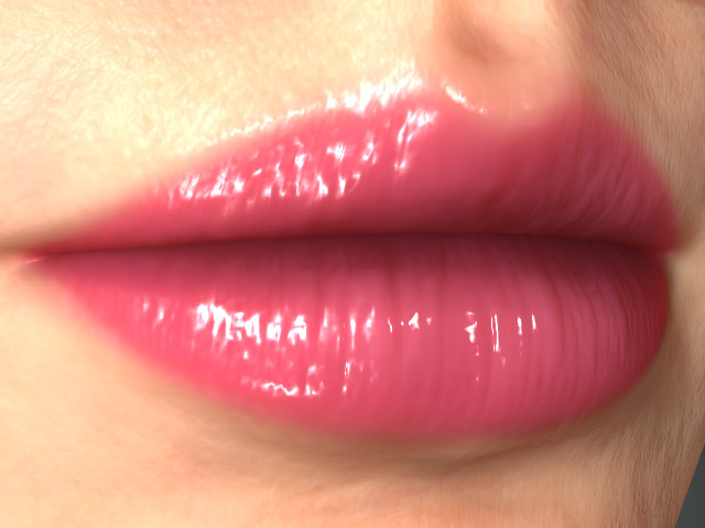

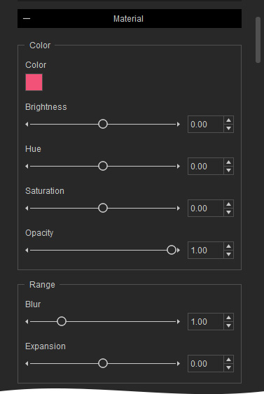

The settings in this group can be used to put base color onto the lips.
- Color and Opacity
Color = #F25278 (peach pink)
Brightness = 0.00
Hue = 0.00
Saturation = 0.00
Opacity = 1.00
Color = #D12C2C (dark red)
Brightness = -0.10
Hue = 1.00
Saturation = 1.00
Opacity = 0.60

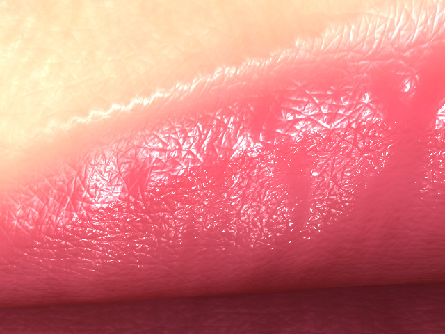

The settings in this group can be used to adjust the range texture for showing the base color of the lips.
- Expansion: This setting expands or shrinks the range of the base color on the lips.
Expansion = 0.00
Expansion = 1.00
- Blur: This setting blurs out the edge of the range.
Blur = 0.00
Blur = 1.00

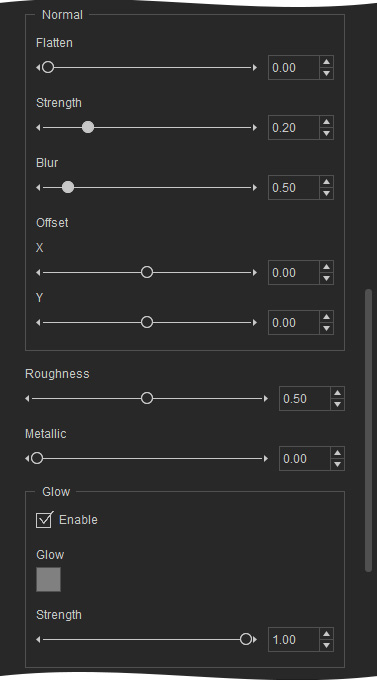

The settings in this group can be used to adjust the bumpiness of the base color on the lips.
- Flatten: This setting sets the blending level of the normal effect.
Flatten = 0.00
Flatten = 5.00
- Strength: The bump strength of the normal.
Strength = 0.00
Strength = 5.00
- Blur: The bumpiness can be smoothed out with this setting.
Blur = 0.00
Blur = 0.80
- Offset X, Y: The normal effect can be transformed independently.
Offset X, Y = 0.00, 0.00
Offset X, Y = 1.00, 0.50

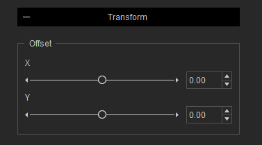

It contains settings for relocating the base layer of the lips. It is useful when the lips range in the Range texture is not ideally positioned.
X, Y = 0.00, 0.00 |
X, Y = -1.50, 0.45 |

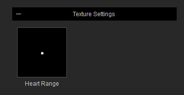

It contains one texture channel for defining the
shape of the heart region. The textures in this section
can be edited if you have purchased and installed the
SkinGen Plugin.
- Heart Range: This texture defines the shape of the heart layer.
Heart Range = None
Heart Range = Custom

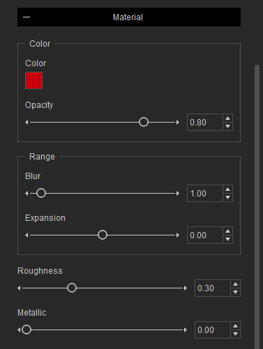

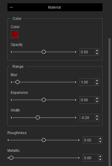

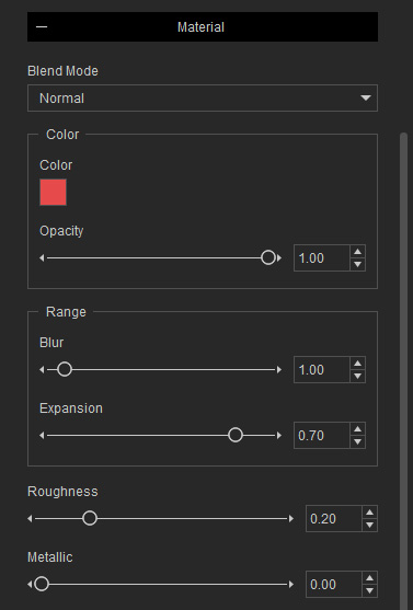

The settings in this group can be used to put color of the heart onto the lips.
- Color and Opacity
Color = #C8000D
Opacity = 0.80
Color = #FF5500 (orange)
Opacity = 0.50
The settings in this group can be used to adjust the range texture for showing the color of the heart.
- Expansion: This setting expands or shrinks the range of the heart.
Expansion = 0.00
Expansion = 1.00
Blur = 1.00
Blur = 1.00
The settings in this group can be used to adjust the smoothness and reflectivity of the heart region.
Roughness = 0.50 Metallic = 0.00 |
Roughness = 0.00 Metallic = 1.00 |

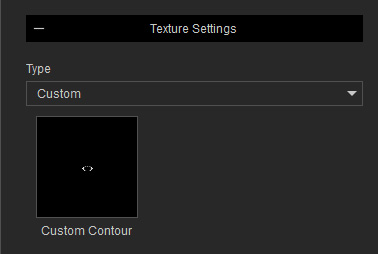

It contains sections for setting the contour layer of the
lips. The textures in this section can be edited if you have
purchased and installed the SkinGen Plugin.
shape of the contour of the lips. The texture in this
section can be edited if you have purchased and
- Custom Contour: This texture defines the shape of the contour layer. You can use the Type drop-down list to choose to use the custom contour texture.
Custom Contour = None
Custom Contour = Custom
The usages of the sliders in this subsection are identical to the ones in the Heart section. The only different slider is the Width in the Range group. Refer to the previous section for more information about the other sliders.
- Width in Range Group
Width = -0.20
Width = -0.30

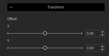

It contains settings for relocating the highlight layer of the lips.
X, Y = 0.00, 0.00 |
X, Y = 0.00, -0.30 |

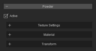

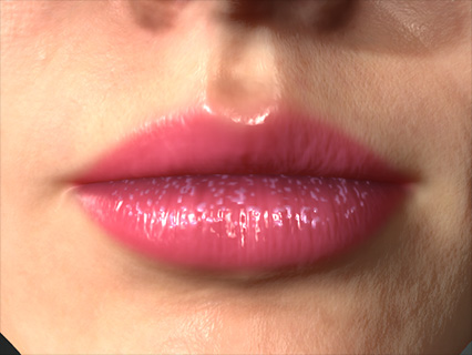

The Powder section contains three subsections with settings for sprinkling powders on the lips.

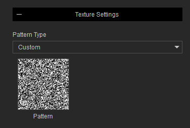

There are two drop-down list and two channels to
determine the sprinkling pattern of the powder. The
- Pattern Type: You can use this drop-down list to determine the pattern type of the powder.
If you choose the Custom from the list, then the pattern is determined by the texture in the Pattern channel.
Powder = Off
Pattern Type = Default
Pattern Type = Custom
Blend Mode: You can determine the color blending method through the items in the Blend Mode drop down list.
Blend Mode = Normal | Blend Mode = Lighten | Blend Mode = Overlay |

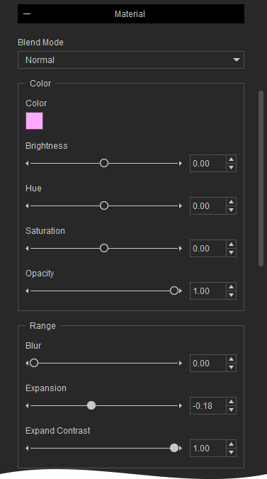

The settings in this group can be used to dye color onto the powder and the blending method to the layers underneath.
Color and Opacity
Color = #FFAAFF Brightness = 0.00 Hue = 0.00 Saturation = 0.00 Opacity = 1.00 | Color = #FF00FF Brightness = 0.00 Hue = -0.70 Saturation = 1.00 Opacity = 0.50 |
The settings in this group can be used to adjust the range texture for showing the powder.
- Expansion: This setting scales each grain of the powder.
Expansion = -0.18
Expansion = 0.00
- Expand Contrast: This setting smooths or sharpens the edge of each grain of the powder.
Expand Contrast = 1.00
Expand Contrast = 0.00
- Blur: This setting blurs out the edge of the powder range.
Blur = 0.00
Blur = 0.40

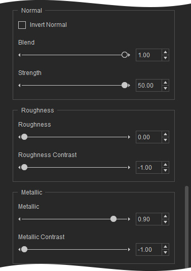

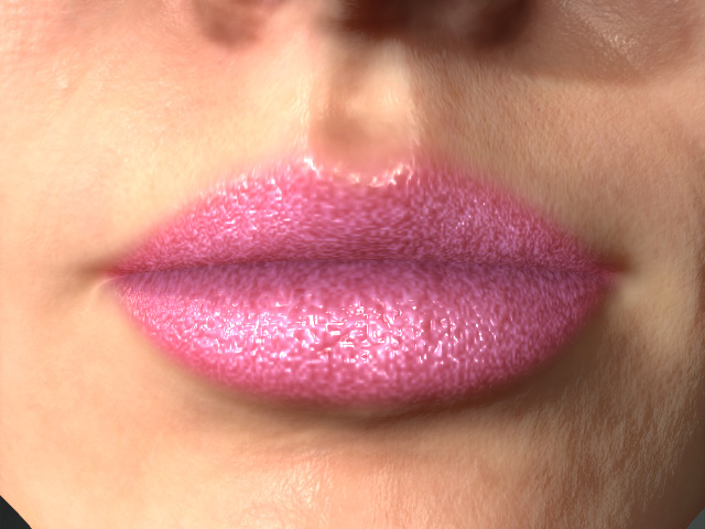

The settings in this group can be used to adjust the bumpiness of the powder.
- Blend: This setting sets the blending level of the normal effect.
- Strength: The bump strength of the powder.
Blend = 1.00
Strength = 00.00
Strength = 50.00
The settings in this group can be used to adjust the smoothness and reflectivity of the noise.

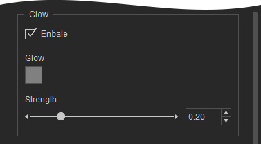

The settings in this group can be used to have the powder glowing.
- Color
Enable = Off
Enable = On
Color = #808080
- Opacity
Opacity = 0.20
Opacity = 0.50

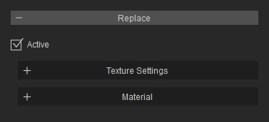

The Replace section contains two subsections with settings for adding one more layer underneath the Base layer in order to create more dramatic effects and varieties of the lip makeups.
There are one drop-down list and two channels to determine the shape and normal of the Replace
layer. The textures in this section can be edited if you
have purchased and installed the SkinGen Plugin.
- Replace Type: You can use this drop-down list to choose to use the Replace Range and Replace Normal textures.
Replace Type = Default
Replace Type = Custom

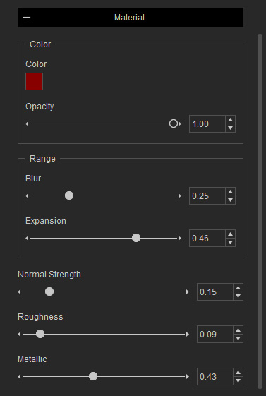

The settings in this group can be used to dye color onto the replace layer.
Color and Opacity
Color = #880000 (chrome red) Opacity = 1.00 | Color = #FF5500 Opacity = 0.50 |
The settings in this group can be used to adjust the range texture for showing the Replace result.
- Expansion: This setting scales the Replace Range texture.
Expansion = 0.50
Expansion = -0.20
- Blur: This setting blurs out the edge of the Replace Range texture.
Blur = 0.25
Blur = 2.00
The setting can be used to determine the strength of the normal effect on the Replace layer.
- Normal Strength
Normal Strength = 0.00
Normal Strength = 0.50
