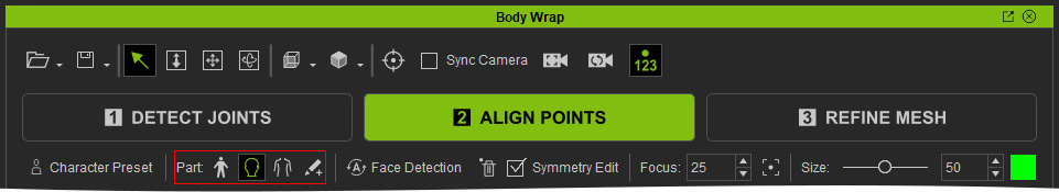

Using Part Modes
The Part modes provide different ways to assign Align Points according to the area of the character being aligned.
Available Part Modes
Mode |
Description |
Full Body |
Assigns Align Points across the entire character (1 ~ 218). |
Head |
Assigns Align Points only to the head (1 ~ 35). |
Body |
Assigns Align Points only to the body (36 ~ 218). |
Extra |
Allows Align Points to be manually assigned for more precise alignment (219 ~ ). |
- Use Extra when additional points are needed to better describe areas with complex or highly detailed shapes.
- The more accurately corresponding Align Points are positioned on the two model surfaces, the more precisely the CC5 HD character can be conformed to the imported model. Adding more points can provide greater control over areas with complex shapes.
Refer to the Aligning Points section for more information.
