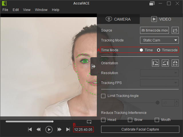

AccuFace (Video Mode)
A
Time Mode
  • Displays the current timecode of the video in B.
  • Transfers the captured facial streaming data including the timecode through Motion Live to iClone.
  • See also: Motion Live Online Manual.
B
Timecode
The timecode display for the playbar.
  • Time Mode > Timecode starts the playback from the starting time in the video.
  • Time Mode > Time starts the playback from "00:00:00:00".
