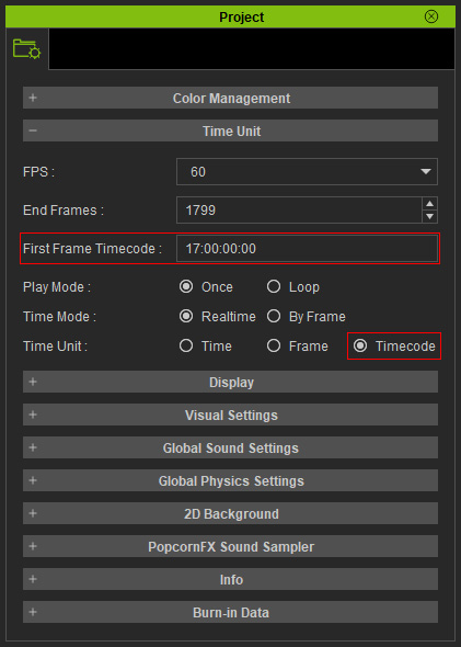

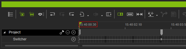

- In the Project panel, type in the desired start time for the first frame.
- Choose the Time Unit > Timecode options
The digits stand for hour (H), minute (M), second (S) and frame (F).
- The starting timecode of the project will be set to the custom time.

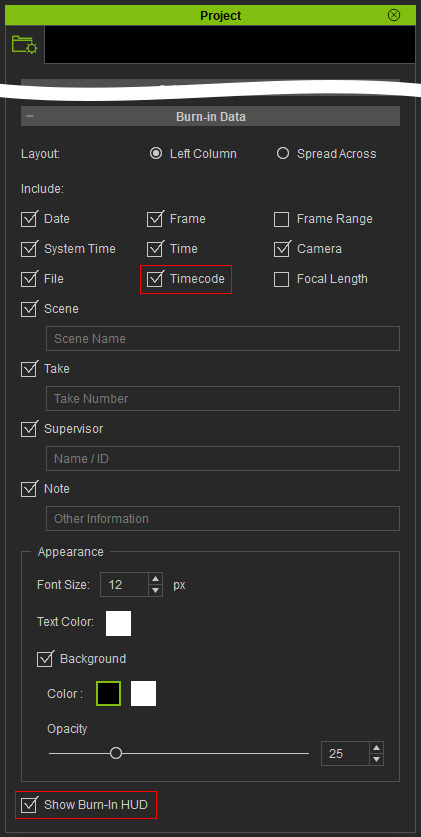

- Activate the following options under Project > Burn-in Data section (especially the Timecode option).
- Make sure that Show Burn-in HUD is enabled.

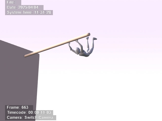

The burn-in HUD will be overlaid on the viewport.

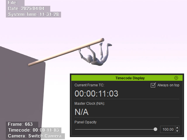

You can also open the Timecode Display panel on the screen for better observation.

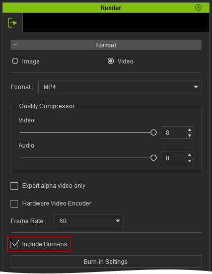

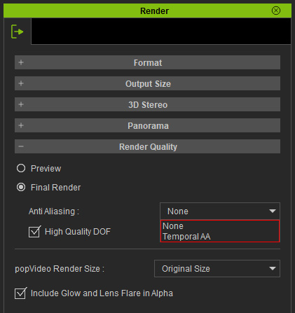

- Open the Render panel, activate Format > Include Burn-ins and click the Export button.
You can click the Burn-in Settings button underneath to adjust the settings in step 4. - Set Render Quality > Anti Aliasing to "None" or "Temporal AA".
