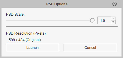

When you use the PSD launch feature in the Stage or Composer mode, you will first encounter a dialog window asking you to enter the target size for exporting the prop.
- The default value of "1.0" for the PSD Scale slider means it will export the current prop at 100% scale.
- Please note that the export size does not actually change the prop's width and height in Cartoon Animator. It only changes the resolution of the images.

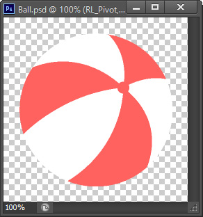

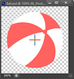

For the PSD Launch in Stage mode, the image structure of the prop is the same with the PSD Launch in Composer mode, however, the layers of their pivots will be invisible.
Pivots are hidden in images launched from Stage.
Pivots are shown for images launched from Composer.
