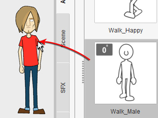

Apply a G1 or G2 character.
Apply a 2D motion from the
library.
Note:Please note that not all 2D motions are suitable for G1 characters. Please refer to the Using Character Motions section for more information.
The character will start to perform the applied 2D motion.
