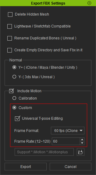

- Frame Format: This drop-down list contains templates for specific frame rates.
- Frame Rate (Custom): you can enter a custom value in this field. Higher values results in more precise motion at the cost of the extra file size of the exported FBX file.

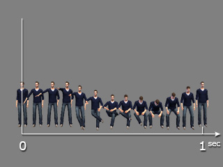

Frame Rate dictates the amount of sampling per second of animation.
Given a motion with different pose per frame in one second duration:

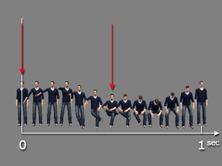

- Frame Rate at 12 fps (minimum limit in Character Creator):
Sampling times are interpolated at every other frame.

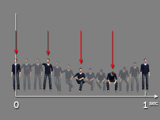

- Frame Rate at 24 fps:
Sampling times have much better animation fidelity.
