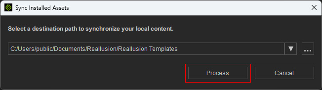

If the contents are installed on the default path, but they appear uninstalled in Content Manager, then follow the steps in this section.
- Execute the Content Manager Menu > Sync Installed Assets... command.
- Choose the Template Path(s) radio button. Activate the Default checkbox.
- Click the Start button and the contents will be retrieved later.

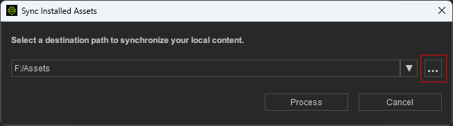

If the installed contents have been stored in a known folder with initial file structure, then you can follow the steps in this section.
- Choose the Specific Path radio button.
Click the ... button and pick a folder in which the assets are installed.

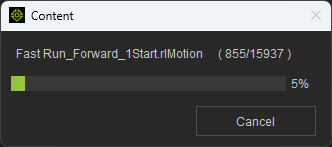

- Since the file structure is left untouched, you can deactivate the Smart Scanning checkbox to accelerate the synchronizing procedure.
- Click the Start button.
- After the procedure is done, the installed contents will be retrieved and displayed as installed again.

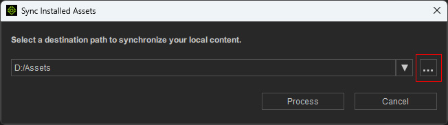

If the installed contents have been manually moved to a known folder, but the file structure has been changed, then you can follow the steps in this section to sync the files.
- Since the file structure is changed, activate the Smart Scanning checkbox. However, it takes longer to synchronize the assets.
