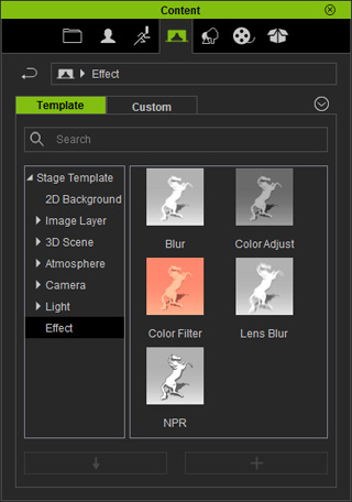

Switch to the Stage tab in the Content Manager. You will see
several built-in templates in the Effect library.
Double-click on one of the templates.

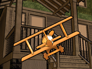

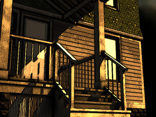

NPR (Non-photorealistic Rendering) effect applied -

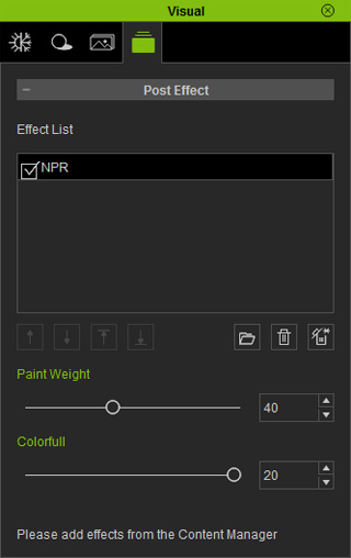

- Switch to the Effect tab in the Visual Settings panel.
Select a template in the Effect List.
Under the list pane, drag the slider to adjust one or more parameters provided by the effect.

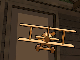

Effect: NPR (Non-photorealistic Rendering)
Paint Weight = 100
Colorful = 20
Paint Weight = 40
Colorful = 6

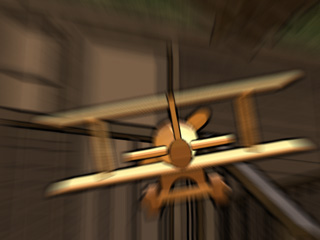

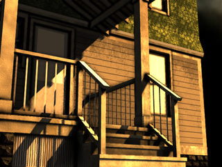

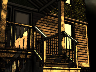

Effect NPR applied

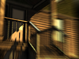

Effect NPR + Lens Blur

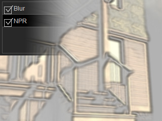

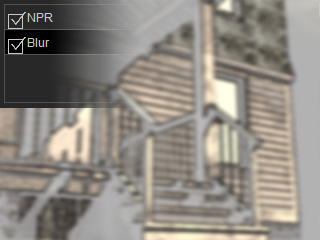

The order of some effects in the list can cause different result since the effects are layer-based filters. The
outcome of an effect is produced according to the effect on the lower layer in the list.

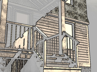

Effect NPR applied first
Effect Lens Blur applied afterward
Effect Blur applied first
Effect NPR applied afterward
