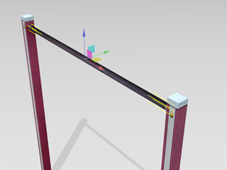

  1. Select the bar which will be reached by a character.
    The bar has only one pivot.

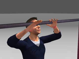

  2. Select a character and have both hands reach the bar.
    Both hands reach the same point. Penetration occurs.

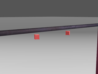

  3. Apply two primitive props and move them closer to the bar. Attach the props to the bar.

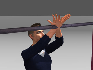

  4. Reach both hands of the character to the dummies.
    Please refer to the Setting Prop as Dummy section for more information.
  5. Adjust the hand gesture. Please note that you may show / hide the dummies by using the shortcut, Ctrl + D.
