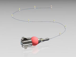

  1. Apply a rocket and have it move along a path; remember to turn on the Follow Path.

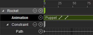

  2. Use the Prop Puppet to record its rotation. You will find that the rotating clip do not have any effect although it is actually recorded into the Animation track. This is because the path key has a higher priority than the animation clip.
  3. Leave the animation clip but delete the keys in the Path track of the rocket.

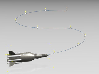

  4. Apply a primitive prop. Attach the rocket to the prop.
  5. Select the primitive props and enable the Set as Dummy box in the Prop section under its attribute tab of the Modify panel.

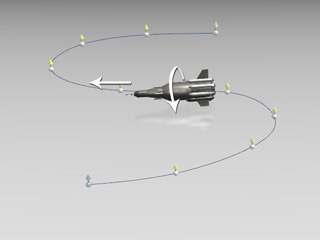

  6. Command the dummy to move along the path. The rocket will go along with the dummy.
  7. The rocket will then rotate while moving along the path. Please note that you may show / hide the dummies by using the shortcut, Ctrl + D.
