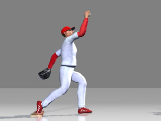

Throwing a Dynamic Rigid Body with Linkage Feature
If you want to produce an inertia effect on a rigid body by linking it to another moving object, change the state of the rigid body to inherit the force from the moving object.

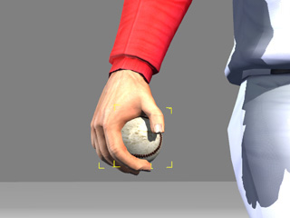

Link the kinematic rigid body to a moving object.
The ball is linked to the hand.

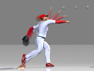

Play back the project from the first frame to simulate the animation. The force from the moving
object will then pass to the physics prop as the physics prop changes to a Dynamic rigid body.
The baseball (Switched to Dynamic) is thrown out.
