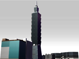

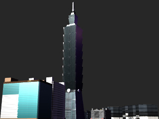

  1. Prepare an iClone project. Remove the Sky and optionally remove the Terrain.
    Sky On
    Sky Off

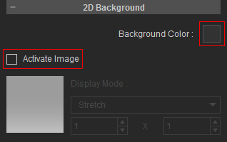

  2. Click the Project Settings button on the play bar, disable the Activate Image box so that the background turns to a solid color.

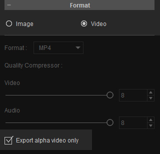

  5. Scroll to the Format section, choose Video and enable the Export alpha video only box.
  6. Click the Export button to export as an alpha video.

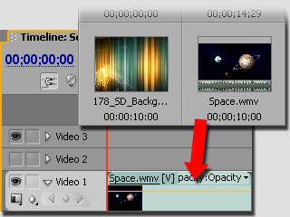

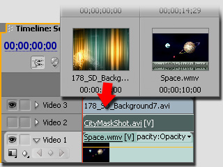

  1. Drag and drop the background video into Video 1 track.

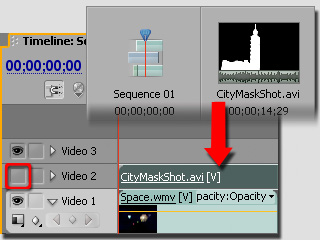

  2. Drag and drop the alpha video into Video 2 track. Disable the Toggle Track Output box to make the video invisible.
  3. Drag and drop the main video to apply the alpha video into Video 3 track.
  4. Optionally, you may adjust the size of the main video.

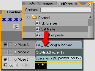

  5. Drag and drop the Channel/Set Matte, in the Effect panel, onto the main video.

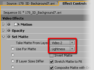

  6. In the Effect Control panel, collapse the Set Matte effect and set the two settings as shown in the illustration below.
