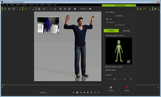

Please note that the steps in this page is suitable for Kinect for XBox 360 or Kinect for Windows.

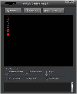

button to connect the plug-in with your Microsoft's Kinect Sensor, and start
receiving motion data from it.

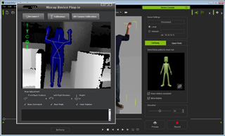

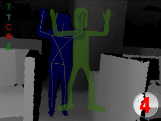

Your body turns bluish or purple as soon as the plug-in detects you. The first icon will turn green. |
Your body parts are framed up with a bone structure. |

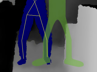

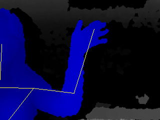

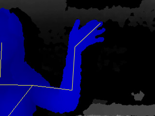

Note: Optimize the Skeleton Structure Result |

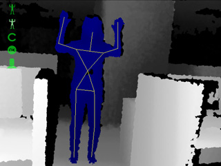

General detection result. |
Wrists and head motions are detected with Microsoft's Kinect Sensor installed on Microsoft Windows 7 or above. |

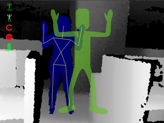

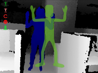

button and wait for
the C icon to turn green.
Note: |
Hold the pose and wait until the end of the countdown. |
You can now start to move. Your motions will be captured afterwards. |
