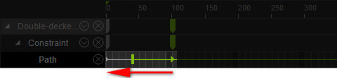

When you have selected the position keys for picking path on a target control point, you can then see the keys under the target prop's Constraint / Path track in the timeline.
Since there are several keys set for picking path, you can then drag and pull these keys to set the speed for it to get to the destination in the limit time of frames.
Now adjust the key to frame 100. You may now see the bus runs even faster to get to the destination in these frames.
