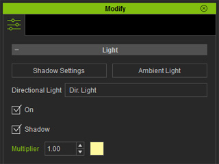

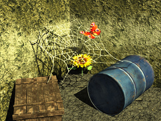

  1. Prepare a project with a default light.
  2. Select the light in the Scene Manager and go to the light modify panel.
  3. Change the light color to light yellow.
  4. Increase the light strength by adding values to the Multiplier.
    Multiplier = 2.5
    The light is brightened while the color of the light remains the same.

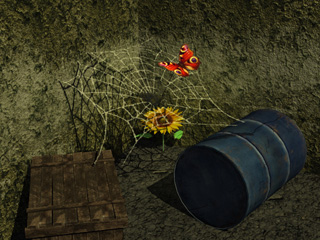

    Note:
    • If you use the color picker to try to increase the brightness of the light, then the result merely turns the entire scene pale; also the contrast will not increase.

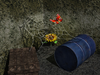

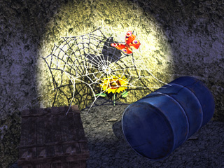

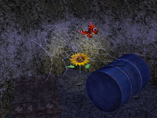

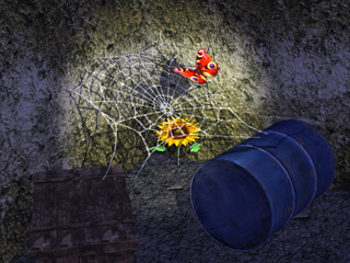

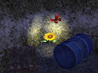

Multiplier, Spotlight and Point Light
With the same concept, you may use the Multiplier to highlight the light center cast by the spotlight or point light.
