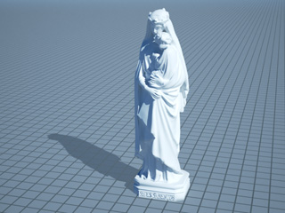

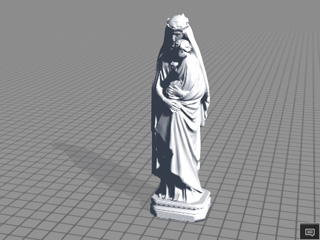

Prepare a project in iClone.
Click the Render Scene button on the
iClone Indigo Render toolbar for previewing.
Check out the scene to reveal the material that you want to modify.
