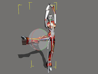

  4. Use the IK/FK methods with the or tools to add an animation layer to the initial animation. The key will automatically be added into the Animation Layer track and be blended in the pose of the animation in the Animation track.
  5. Repeat the same step at a different time frame and you can then fine-tune the initial animation.

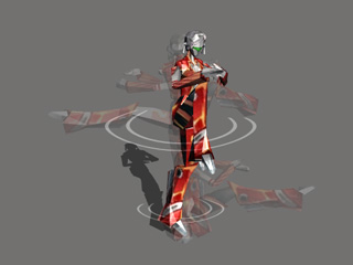

    Adding animation layer keys for offsetting bones.
    The animation layer keys affect the entire animation clip.
